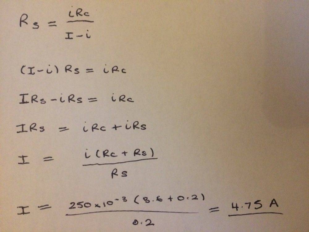

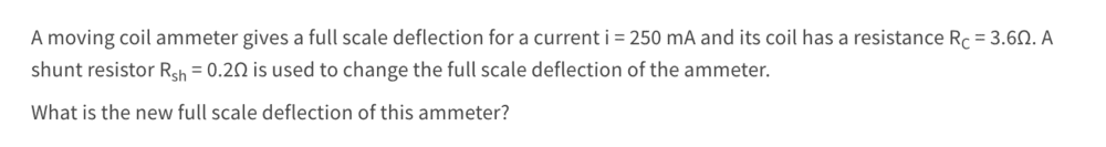

Calculate the new full scale deflection of the ammeter
Rs = iRc/I-i
Question:
My attempt:
Does 4.75 amps for the full scale deflection seem okay?
Thanks for any help!
What kind of help would you like ?
Looks good.
