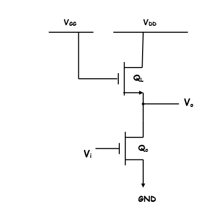

Given
Vdd = 5v, Vgg = 10v, Kn' = 20uA/V^2 (For both transistors), (W/L)o = 10um/5um, (W/L)L = 5um/20um, Vt = 1.1V (for both)
My question is what would be the Vgd, and Vgs of the load NMOS?
So far, what i have is:
The NMOS Load is always in linear mode. Id = Kn[(Vgsl – Vt)Vdsl – 0.5*Vdsl^2]
Vi = Vgso
Vo = Vdso

which is which? does "o" stand for the upper and "L" for the lower transistor?
also need to know Vi.
The O is the lower transistor, the L is the upper transistor (L for Load)

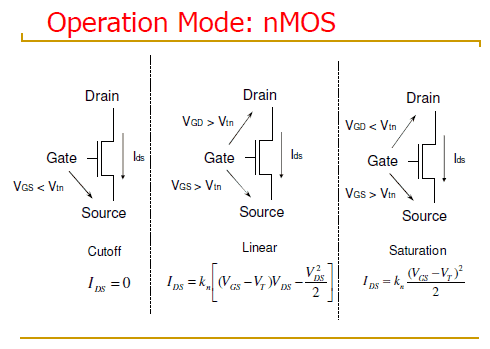

1. You have the L fet always in the linear mode, as you say.
2. assume the o fet is also in the linear mode. Equate the two fets' equations since the current is the same. Solve for all voltages. If the voltages meet the requirements for the linear mode for the o fet, you're done.
3. if not, then assume the o fet is in the saturated mode and repeat solving for all the voltages the same way.
For Vi = +2.5V and +5V the o fet has to be in either the linear or saturated mode.
For Vi = +1V it should be obvious what the mode of the o fet is.

So what would be the Vgs of the O transistor seeing as how there is a Vgg tied to the O transistor
rude man said:
I will ty to do a computation for Vi = 5V and 1V, maybe 2.5V also. Later.
You mean QL, not "the O transistor", right? To avoid further confusion, I am using the subscript "1" for Qo and "2" for QL henceforth:
You have every voltage except Vd1 which is also Vs2:
Vg1 = Vi (i.e. 1V, 2.5V and/or 5v)
Vg2 = +10V
Vd2 = +5V
Vs1 = 0
So, solve for Vd1 which is also Vs2.
