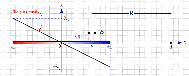

A thin rod of length 2ℓ has a linear charge density that is λ0 at the left end but decreases linearly with distance going from left to right in such a way that the charge on the entire rod is zero.
What is the magnitude of the electric field along the rod's axis at a position P that is a distance d>ℓ to the right of the center of the rod? Use the notation l for the variable ℓ.
Express your answer in terms of the variables l, λ0, d, and Coulomb's constant k.

Try placing the center of the rod at the origin. You should be able to come up with a simple expression for the charge density that uses the sign of x to set the sign of the charges. Then you can integrate from -L to +L.
Starting with a symmetrical layout often simplifies the math.

You want to integrate over x from -L to +L, but the distance that you use in Coulomb's law must be the distance between the point in question (d) and the charge element dq. That distance varies from d + L to d - L. So your integral is going to be a bit more complicated because you can't pull the ##d^2## out.
Here's a diagram:
Likes Slightly Odd Guy and mattbeatlefreak

Take a look at the diagram and the line representing the charge density in particular. What is the slope of that line? What's the equation of the line then? ##λ(x) = ?##
If both x and d are measured from the origin, what is the distance between them? (It's labelled "R" in the diagram). Note that Coulomb's Law for the electric field uses ##R^2##. If it was electric potential you'd use ##R##.
If the integral is more complicated than what you've dealt with up to now then you might try a table of integrals or the Wolfram online integrator. Or, see if you can cast it into a generic form and take it to the Calculus and Beyond homework forum to work on it. You'll need to take a stab at it first though; It looks like it might be one of those integrals that requires variable substitution and maybe integration by parts.
The slope is y/x, so in this case it would be -λ/L.
If I use R2 in the integral, won't my answer be in terms of R? I can only use l and d for distance measures in my answer, that is why I was trying to avoid using the R. Thank you for the advice with the integral, I'll give it a try first if I can ever figure out how to set it up
Well, it would be ##-λ_o/L## for that particular line, right? So ##λ(x) = (-λ_o/L) x##. Multiply that by dx and you get a charge element dq at location x.
The R is just a label in the diagram designating the distance that would be the required "R" in Coulomb's Law. Examine the diagram and write its equivalent in terms of x and d.
Okay. Good luck!
