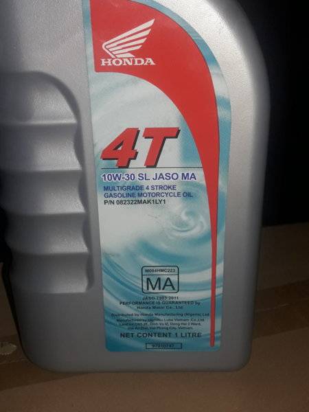

Hello house, nice to be here, advices on oil type,I have below oil picture can in work in my Honda crv 2000 with oil specification 5w 30, I use the vehicle in Africa, but below picture is 10w 30

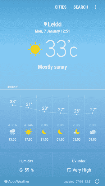

Appreciate for your reply, as said >If you live in a tropical area where temperatures are consistently high and it never gets near freezing, an even higher starting viscosity oil like 15w40 can be used.
The temperature of my area currently is 33°

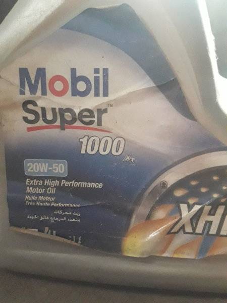

As attached and another oil i have 20w 50. Pls kindly advice weather temperature to use. Can i add oil treatment?

you run the risk of failing to lube the engine properly. The oil galleries in the engine block were sized to use the factory rated oil. this is without additives. When you change this you risk the lubrication of that oil to the proper pressure in the oil galleries. Thicker is not always better and may harm things. Do not forget that oil plays three big roles..it lubricates, it cleans and it cools. Too thick may not clean properly and carry away heat as it should. If you are going to do anything to improve your hot climate situation, find a larger capacity oil filter to add more oil capacity. Add an external oil cooler.
Maybe ...maybe with caution go to up one on the weight but that is max..in my opinion

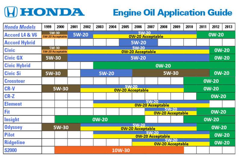

Likes russ_watters, Abimotek, anorlunda and 1 other person
33 degrees F or C?
berkeman said:
33 degrees F or C?
Frm attach I think is 33°C

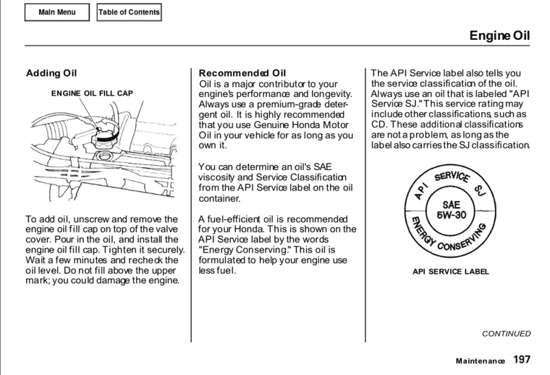

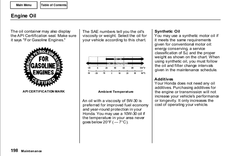

So the first oil you pictured there is a motorcycle oil. I wouldn't recommend using that, though I suppose you could in a pinch. 20w50 is also a poor choice, since it is dramatically thicker than the factory spec 5w30. You should look for a 5w30 automotive oil ideally (a 0w30 would also be acceptable), or if the car will exclusively be used in hot climates, a 40 weight might not be a terrible idea (0w40, 5w40 or 10w40). It is usually acceptable to go up one level in viscosity from the factory spec on older engines or ones used in hot climates (or in this case, both), but you should never go down from factory viscosity or up more than one step without a good reason. Stick with a 30 or 40 weight automotive oil.
Also, I disagree with Mike about one thing: there's no harm in using synthetic on an engine that doesn't call for it (and actually, there can be a number of benefits). If the engine calls for conventional, use either conventional or synthetic, but if it calls for synthetic, make sure to use it.

Did you mean I can you the 10w 30 multigrade attached?
The oil in your picture is specially made for motorcycle engines with one oil system for the engine, gearbox and wet clutch system. The oil for car engines are specially made to reduce friction as much as possible between the piston and cylinder. This promotes better fuel economy. If you use this type of oil with a wet clutch, you might not have enough friction for the clutch to efficiently work. The classification that relates to that on your oil container is JASO MA:
4T specifications
Modern passenger car engine oils contain more and more friction modifiers. While this is the good thing for those segments (reduces wear and fuel consumption) it's bad for the motorcycles. At least for those motorcycles which use engine oil to lubricate their transmission and wet clutch. JASO introduced the MA and MB specification to distinguish between friction modified and non friction modified engine oils. Most four-stroke motorcycles with wet clutches need a JASO MA oil.
Going back to the Honda owner's manual presented earlier, the motorcycle oil would probably not fulfill this recommendation:
A fuel-efficient oil is recommended for your Honda. This is shown on the API Service label by the words "Energy Conserving." This oil is formulated to help your engine use less fuel.
But as long as you have the API SJ (or better) classification, it should be safe to use with your engine.
But I also wouldn't recommend it, it won't improve anything in a car engine, and I bet this oil cost more than regular car oil of the same standard.
