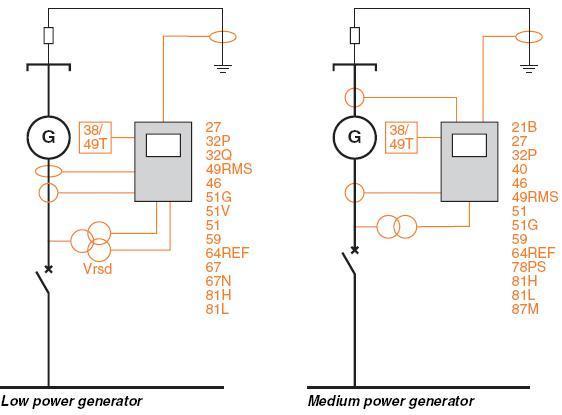

According to some normal practice, the illustrated ANSI code function in attached figure are used for low and medium power generators.
Field loss is detected either by a delayed reactive overpower protection unit (ANSI 32Q) for high power rating systems or by an under impedance protection unit (ANSI 40) for “islanded” power systems with generators, or by direct monitoring of the excitation circuit if it is accessible (ANSI 40DC).
