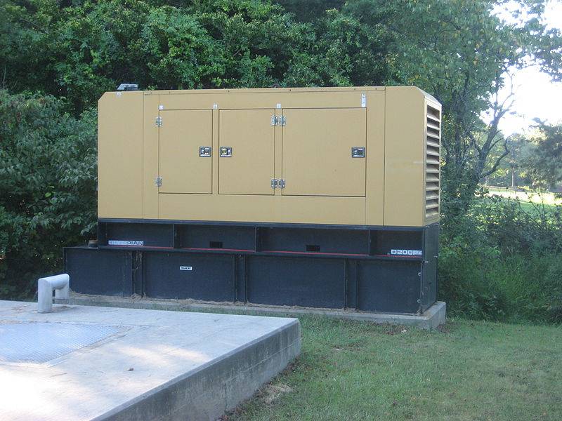

I have seen many establishments having a backup electric supply using a Diesel Generator Set (AC / 3 phase). e.g. Something like in the Photo Below.
What happens if the connected load grows beyond the capacity of a single generator? e.g. The unit in the photo is rated for 200 kVA. Suppose the load requirement grows can a second similar unit be bought and connected in parallel?
Or do they have to scrap the 200 kVA unit and buy a new (say) 400 kVA unit?
If paralleling AC generators what kind of circuitry is needed?
Yes. But it is highly recommended that second 200 kVA unit be VERY similar (read "same") to the first one.
"Circuitry" for synchronisation is a must have.
I think that the machines must be similar only in their speed-droop and voltage-droop characteristics, for ease of real and reactive load sharing. Without, they can still be run together but with more monitoring and manual control.

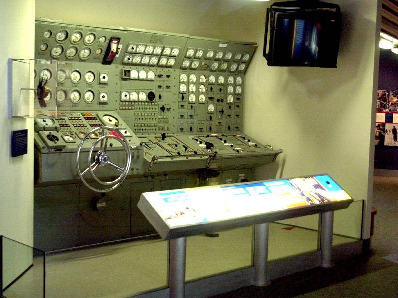

I retired in 1995. I'll try to link to a picture of my control panel that I used in the La Spezia story. It has been a bit restored.

@Doug
Fascinating photo. What was your role on the ship? Can you elaborate on some of the dials & gauges on there? I'm just so terribly curious.
At that time I was an enlisted nuclear electric plant operator, trained first as a telephone/instrument technician.
The panels, from left to right, are steam plant control dominated by the throttle handwheels, then the reactor control panel and the electric plant control panel. They have been very heavily edited, presumably for security purposes, and I'm a bit hesitant to be too precise. It is amazing enough that this particular ship's equipment was saved.
The real thing un-edited.
