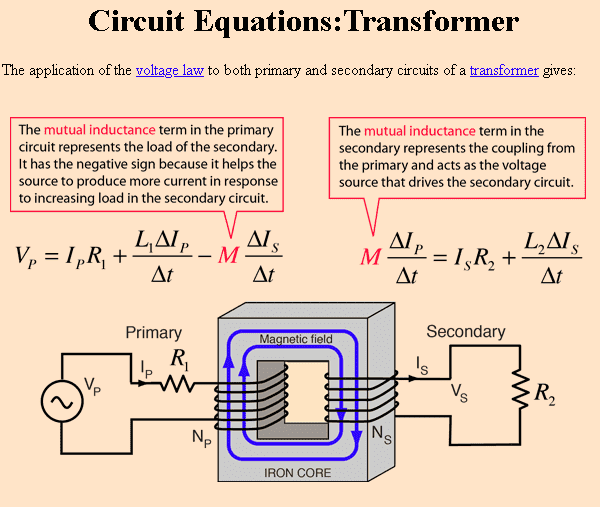

Hyperphysics tells us how mutual inductance relates primary to secondary inductance
Knowing Lmutual and Lprimary allows us to calculate Lsecondaryfrom before i tried to paste Latex
and even there I'm missing the √ radical in numerator of Lprimary... but i can't make Latex write the expression
##Lsecondary = \sqrt {\frac {Lmutual ^2} {Lprimary}}##
where my L's are fractions themselves .

using the tool of Mutual Inductance
where k is the fraction of flux that couples both coils, ie doesn't leak.
k of 1 is 'ideal coupling'
L2 then = ##\frac{M^2}{k^2L1}##

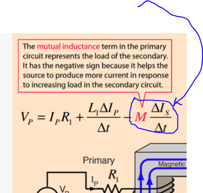

we redraw the circuit showing the interaction between windings as dependent voltage sources
in the primary is a dependent voltage source , with polarity aiding the applied voltage, with amplitude jωI2M
and
in the secondary is a dependent voltage source, with polarity to satisfy the dot convention, and of amplitude jωI1M .
as drawn above.
So they criss-cross. Primary current sets secondary OC voltage, and secondary current reduces primary counter-emf.
Mutual inductance M takes care of the turns ratios and k handles leakage flux.Ignoring the capacitor that was in the original image

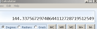

Pq = 144.3 var
and since the only resistance present is the ten ohms of r1, power must still be 250 Watts
giving total VA of ##\sqrt{250^2 + 144.3^2} = 288.65...## VA
which dictates an impedance angle of 29.99354 degrees -
(for a textbook problem that's sooo diggone close to 30 that i have to think it's result of truncation
but i'll work with his numbers as given , however i will round to 4 digits)
288.65 VA at 5 amps dictates 57.73 volts
144.3 vars at 5 amps dictates 28.86 volts across the inductance, and that divided by 5 amps = 5.772 ohms
250 watts at 5 amps dictates 50 volts across the resistance
and sure enough, that makes a right triangle because √(502 + 28.862) = 57.73...
so I'm confident enough to continue
Writing KVL around primary
we find
##V1 = I1R1 + jωI1L1 -jw MI2## and we'll call that EQ(1)
and
and L2 = ##\frac{M^2}{k^2L1}##
Now
##I2 = Vsec / L2## EDIT make that ##I2 = Vsec / jωL2## and i forgot more jω's so added them in following lines , and i tried but latex won't let me make them red
and ##Vsec = jω MI1##
so ##I2 = jωMI1 X \frac{k^2L1}{M^2}##

If the angle were exactly 30 degrees, ie Pq were 500/√3 sin(30) = 250/√3 = 144.337etcetera
then volts across reactance (1-k^2)jωL1 would be ##\frac{Pq}{I1} = \frac{\frac{250}{√3} volt-amps}{5 amps} = \frac{50}{√3} volts ##
and (1-k^2)jwL1 would be ##\frac{volts~across~it}{amps~through~it } = \frac{10}{√3} Ω##
and (1-k^2)L1 would be ##\frac{10}{ω√3} = \frac{10}{100π√3} = \frac{1}{10π√3} ## Henry
jω(1-k^2)L1 = 10/√3
