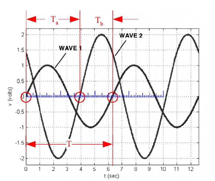

I am asked to compute the phase difference between the two waveforms shown:
Also how much does wave 1 lead wave 2?

I am confused with the question itself. I know I am merely looking for the phase difference ##|\theta_1 - \theta_2|## between the waves.
Wave 1 appears to be a plain old sin wave (##v_1 = 1*sin(\omega t)##). Wave 2 is lagging behind wave 1 (##v_2 = 2*sin(\omega t + \phi)##).
Is that the right approach? Or do I read the periods of each wave off?
The phase is relative to the wave period ##T##, so you need to figure out both ##T## and ##\Delta T## (as you can see from the equation you posted).

Sorry for the double, but I think I realized something. Is the period of both waves and not just one roughly 6.25? The time difference would be roughly 0.15.
Look closely — I think both waves have the same period ##T##.

The formula you wondered about comes about from considering ##T## to be the period and ##\Delta T## to be a portion of ##T##. That means ##\Delta T / T## is the fraction of a full cycle of ##2 \pi## radians. So then:
$$\phi = \frac{\Delta T}{T} 2 \pi$$
As near as I can tell both waves have the same period.
One way to do this sort of problem is to identify similar zero-crossing points and use them for the instants of time that you'll be considering. By "similar" I mean where both waves are crossing the zero level in the same direction. Here's your picture with three such crossing points indicated. I've also laid a "ruler" along the zero V axis for convenience.
Note that two time differences are indicated, ##T_a## and ##T_b##. One of them is smaller than the other. You generally want to take the smaller one because it will will yield a phase difference less than 180°. But it may make you re-evaluate whether wave 2 is leading or lagging wave 1!
If you are required to consider that wave 1 leads wave 2, then you'll have to live with the larger angular difference in this case.

Cool, I now get:
##\theta = \frac{2 \pi}{T} \Delta T = \frac{2 \pi}{6.25} (0.15) = 0.151 rad##
I don't see where you're getting the 0.15 second value for ##\Delta T##.
##\Delta T## was not explained. It was only mentioned as the time difference once.
I think that it's the difference between the peaks? So ##\Delta T = 4##.
Then ##\theta = 4.02 rad##.
It's the difference between any two equivalent points on the waveforms. Peaks are an example. But I find zero crossings can be determined more accurately. That's why I pointed out three choice ones on the figure.
