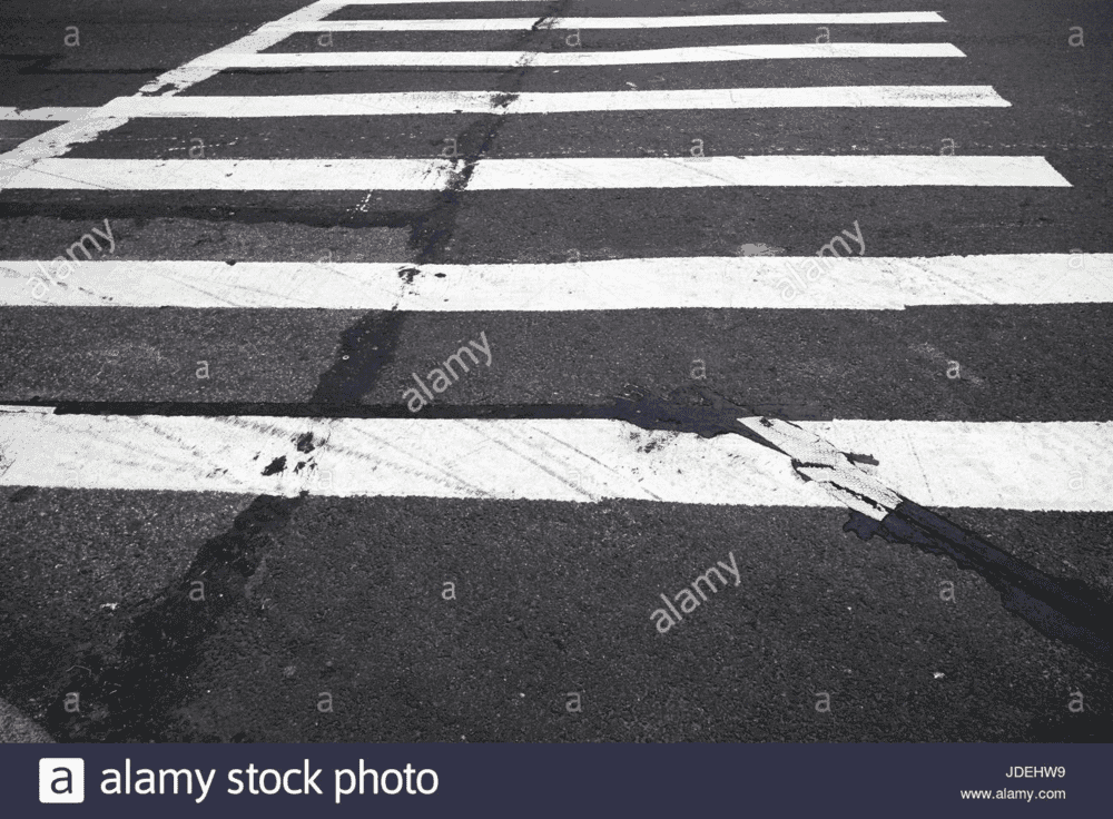

I used a Google Images search for crosswalk paint lines crooked, and got a few hits. Here is one where there is a fair bit of damage to the painted lines (from asphalt cracks?), but it looks like there is paint displacement in the upper left of the image...
https://c8.alamy.com/comp/JDEHW9/crosswalk-painted-on-tarmac-downtown-new-york-city-usa-JDEHW9.jpg

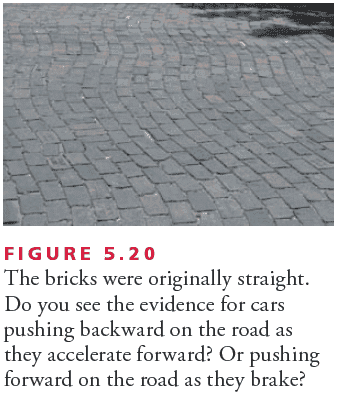

Perhaps, but quality asphalt doesn't do this.
But it also happens with brick roads that have a loose foundation.
Here's a pic of the same phenomenon scanned in from the 12th edition "Conceptual Physics" textbook by Paul Hewitt:
This one is good, but not as dramatic as the cross-walk lines.
I'm going to claim "fair use" for the use of this image, with many thanks to Hewitt.

The evidence for that is where?
Seems to me the stones were laid that way - some curves alongside the edge of the road and the narrowing of the road at the top.
I can see some displacement of individual stones, but not the whole structure.
A before and after comparison would have been appropriate from the author, and a more complete picture of the road.

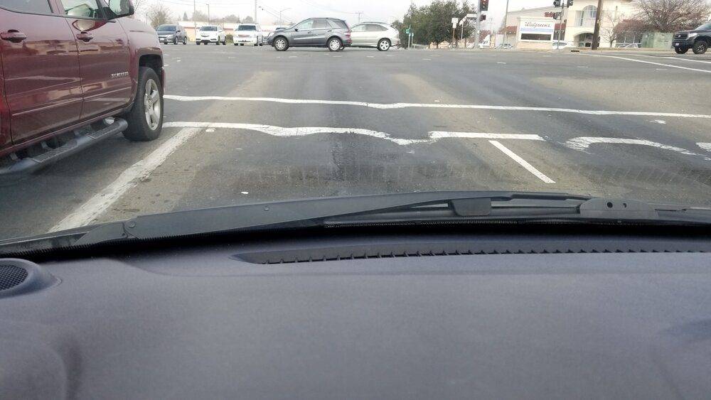

OK, my wife got tired of me talking about this, so she took this picture a few miles from our house.
Generally, these kinds of shots better when you're looking down the length of the line, but this is still pretty good.
https://www.physicsforums.com/attachments/275044
There were some I saw a few years ago where the distortion was REALLY extreme, like the lines were pulled back half a meter or more.
Doesn't really look like improperly applied tape.
Looks more like improperly applied road. :)

I responded with some 'scepticism' of the pictures given before, but this one really shows the effect.
I was looking for something such as in @Lnewqban's link of Pavement Distress - Corrugation and Shoving as a telltale sign - a perpendicular buildup or depression, but some of the obvious signs may not be there at all with all the continuous traffic flow.
Yes, I suppose I'm surprised by how many people in this forum have NOT seen this effect ... a decade or so ago, these kind of pictures were all over the place ... some REALLY extreme effects were common. And now it's like these pictures have just vanished from the Internet.
It's a bit like someone asking "Who's Elvis?"
(OK, maybe that's a little bit of an exaggeration.)
Anyway, when teaching physics, it's nice to have a picture of a very real and tangible example to remind students what direction the forces are in.
It's important to emphasize, that this is the effect of a drive wheel ... the wheel on the axle connected to the motor, which it pushing against the ground to move forward.
The non-drive wheels are not powered and are basically pushed or dragged, and the forces of friction on those wheels are in the opposite direction.

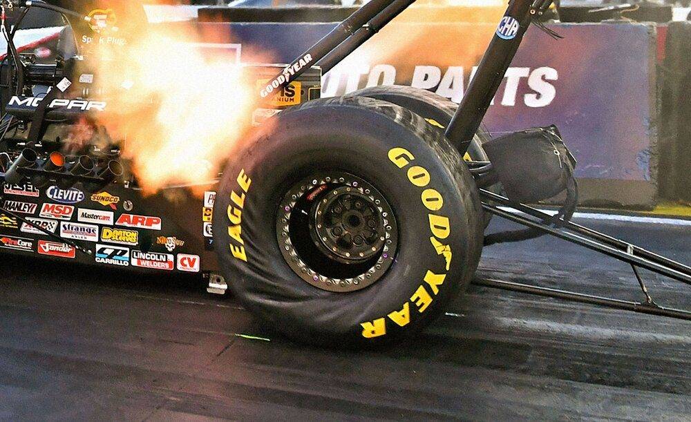

Here's another photo that is equally impressive, of the wheel of a dragster as the axle is providing torque to the wheel, which is delayed in moved through the tire because of friction with the ground. The result is a bit of a shearing effect, which would rip the tire to pieces if it were not made so well.
