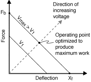

The electromechanical coupling factor, k, is for free deflection. Here, the piezoelectric primary is constrained vertically to maximize the force on the secondary.
From http://www.piezo.com/tech2intropiezotrans.html
Free deflection (Xf) refers to displacement attained at the maximum recommended voltage level when the actuator is completely free to move and is not asked to exert any force. Blocked force (Fb) refers to the force exerted at the maximum recommended voltage level when the actuator is totally blocked and not allowed to move.
My inclination for the answer is that k depends on the open circuit elastic compliance, while the short circuit compliance is used when electrically driving the ceramic and when extracting the output power.
