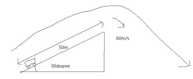

I try to sketch this diagram
kelvin56484984 said:
vx is equal to 60m/s?
Vx is not 60m/s. It is the total velocity of projection, inclined at 30 degrees with the horizontal. That's what you are supposed to show in your diagram.
Now, from your diagram, you can see the net vertical displacement of the rider. You know the acceleration due to gravity g. Set up an equation relating displacement with time and g and find the time taken by the rider to reach the ground. You can then use this time to find the horizontal distance covered before landing.
But how to use projectile velocity find the Vi?
50*sin30=Vi*sin30*t -1/2gt^2
x=x0+Vi*cos30t
these equation?
Right! You have Vi already.
Vi equal to 60?
Vi equal to 60?
Yes.
But I substitute vi=60 to
I get t=0.995s or 5.127s
then put the t =5.127 into
x=x0+vi*cos30*t
then x=266
what's wrong with it?
Well, the displacement should be negative i. e. -25m.
No. He leaves the ramp at a speed of 60m/s. At that time, he is already at a height of 50 sin(30) m.
