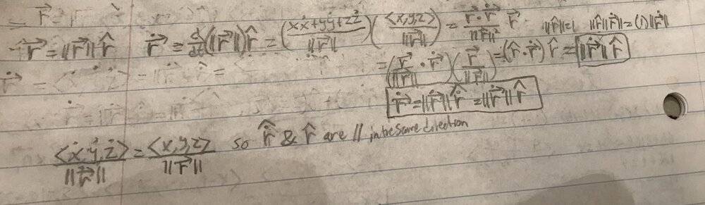

EDIT: I made it through the problem but did I do it right?

Sorry for the confusion everybody, I was just trying to show that one side of 3.) is equal to the other side.
winnie_d_poop said:
3.)##\dot{x}\hat{i}+\dot{y}\hat{j}+\dot{z}\hat{k}=\frac{x\hat{i}+y\hat{j}+z\hat{k}}{\sqrt{x^2+y^2+z^2}}\frac{\dot{x}x+\dot{y}y+\dot{z}z}{\sqrt{x^2+y^2+z^2}}##
My solution (attached to the original problem) used the definition of the dot product and the fact that the angle between r and v is 0 (both pointed out by delta!) I just want to make sure I didn't do anything wrong and get the right answer by mistake.
Thanks!

What are you actually trying to do here?
