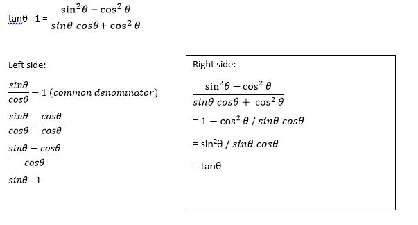

prove the following identity [/B]
no equations required
I've been trying to prove this identity, but no matter what I do, I can't seem to make both sides the same
here is my answer to this qts so far: can someone please tell me what I have to do next?
Im pretty sure I'm supposed to be getting tan(x) - 1 on both sides. So, should I leave the left side the same (keep it as tan(x) -1) and work only with the right side, until both sides are equal?
any help would be appreciated. Thanks.

When you divide a sum or difference, you have to divide all terms. ##\frac{\sin(θ)-\cos(θ)}{\cos(θ)}## is not sin(θ)-1. And you made the same error in the right side.
Leave the left side as it is, and work with the right side. Divide both numerator and denominator with cos2(θ), for example.

Leave the left side as it is. In the right side, we notice that we can use the formula: a^2 - b^2 = (a-b)(a+b) in the numerator. Try to find the factors of the denumerator and the problem becomes quite trivial then.
ok so for the right side,if I use the formula: a^2 - b^2 = (a-b)(a+b)
then it becomes:
(sin(x) - cos(x)) (sin(x) + cos(x))
sin(x) cos(x) + cos^2(x)
how do i solve this??

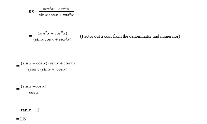

Factor out a cosx in the denumerator:
[sin^2 (x) - cos^2(x)]/[sinxcosx + cos^2 x]
= [(sinx - cosx)(sinx + cosx)]/[cosx(sinx + cosx)]
Then use (a+b)/c = a/c + b/c

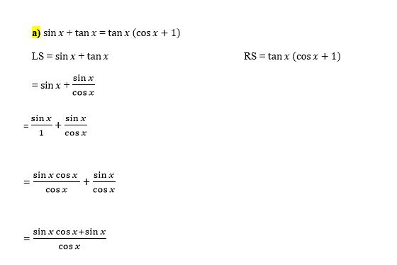

Prove the identity:
Can someone tell me if this is correct? I am not sure if I should have worked on both the right and left side until they were the same, instead of just the left side?
Evangeline101 said:
Prove the identity:
Looks okay,
The second step on the left hand side is a bit strange, but then you fixed it the next step, so probably just a typo.
This step?
should I just take it out then?
Evangeline101 said:
This step?
The next step, it's not equal to ##\frac{\sin{x}+\sin{x}}{\cos{x}}##
It seems to me that working the right hand side would be easier than working the left hand side.

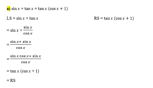

Student100 said:
The next step, it's not equal to sinx+sinxcosx
Okay, I edited it:
Is this better?
  • #31
Student100 said:
That's fine. You just need to be careful, the = is saying something very precise.
what do you mean?
  • #32
Evangeline101 said:
what do you mean?
The above line that I posted, you're saying the original expression is equal to 2tan(x), which isn't true. I know it was a typo, just make sure you're careful is all. No sense losing points on a typo. =)
The fixed solution looks fine to me.

  • #34
Sorry for responding to this thread after it has been marked solved.
Ok, I am proving the exact same identity, I looked through the thread and the explanations were very helpful.
I wrote out the answer, and would just like to know if I have written the answer properly:
LS= tan x - 1
  • #35
Yes I think that's right now.
Hope you see it as simple now, and what you were missing.
