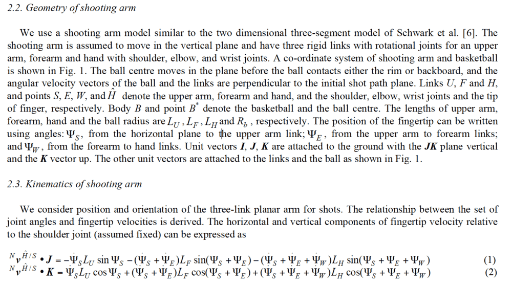

Question regarding this Basketball Kinematics Diagram

Welcome to the PF. :smile:
What a fun problem and question. Can you post a link to the whole paper? I'm not seeing enough of their development in your attachment to be able to help so far.

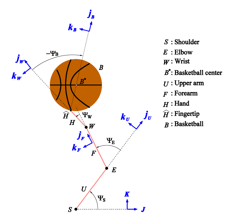

The ball will do both linear and rotational motion.The work done on the ball will be converted in both angular and linear momentum.
