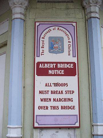

The peak force is much greater than the combined weights of the juggler+juggled objects. The net result would be equivalent to marching (with very heavy steps) across the bridge.
Marching can be quite deleterious to bridges.
