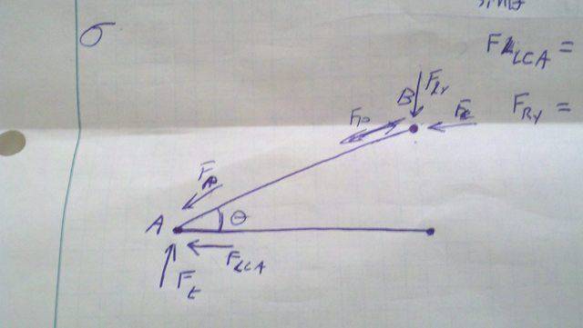

So I am designing the suspension for a small formula car. It's a pushrod suspension much like what is shown below:
[PLAIN]http://f1-dictionary.110mb.com/Images/pullrod_poshrod_push.gif
I am trying to find the required tubing diameter for the loads the car will experience.
Ʃf(x)=0
Ʃf(y)=0
σ=F/A
The free body diagram
The car is assumed to weigh 700lbs, have 60-40 front to rear weight distribution and be in a 2G turn, so the maximum force of the tire is 525lb. θ is assued to be 45°
By the method of joints:
At pinned joint A
Ʃf(x)=0=FLCA-cos(θ)Fp
Ʃf(y)=0=Ft-Fpsin(θ)
At pinned joint B
Ʃf(x)=0=-Fs-Fpcos(θ)
Ʃf(y)=0=-FRy-Fpsin(θ)
So Fp=Ft/sin(θ)
And the maximum force in the pushrod is around 743lb. One of the tubing thicknesses under consideration is 5/8 .035 4130 chromoly which has a yield strength of 70PSI.
Cross sectional area is
∏/4(.625in-.59in)=.0275 in2
Calculating the stress at maximum load is calculated at around 27000 PSI :eek:
I know my statics is rusty but this is wayyyyy off. This tubing thickness is within the range of what other people are using, maybe a bit on the small side. Can anyone point out where I may have gone wrong?
The cross sectional area of the tube is incorrect: A = (pi/4)*(do^2 - di^2)
The min. yield strength for this material is 70000 psi (70 ksi), not 70 psi.
Thanks! makes much more sense now.
