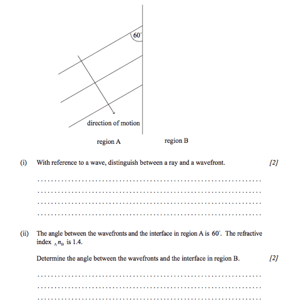

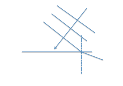

Hi,
A wave is changing from medium A to medium B and it travels slower in medium B than in medium A. If I draw a normal line from the boundary to the wavefront the wavefront in medium B will move away from the normal? I attached to make it more clear
Furthermore, I got this question:
The angle between the wavefronts and the interface in region A is 60. The refractive index anb is 1.4.
What I did was: if 60 between wavefront and boundary, 30 degrees between ray and boundary: sin 30 / sin r = 1.4. I then got between the wavefront and the boundary 69.1 degrees but it is wrong, the mark scheme got 38 degrees. Can anyone help me?
Thanks
It looks like they were specifying the angle with respect to the normal to the surface. (They probably mixed them up.)
Edit: On closer inspection, there's nothing wrong with the diagram or problem statement.

Here's the problem:
What you need in Snell's law is the angle between the ray and the normal.
Oh, sorry, that was a typo I guess... In the diagram, the angle between the wavefront and the normal is 60 degrees. So I did 90-60 to get the angle between the ray and the normal. I did sin 30 / 1.4 while the mark scheme did sin 60 1.4. So the mark scheme is wrong? :confused:
No, the diagram is quite clear. The angle between the wavefront and the boundary is 60 degrees.

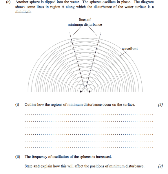

Ah, never mind, I got it now. Thanks! But if you wouldn't mind, could you help me with the second part of the question I linked? I got the first part but I am confused as to what the marking scheme says:
position of anyone minimum closer to centre / minima closer together;
frequency increased so wavelength decreased / correct explanation in terms of double-slit equation;
That's the trick. Do you realize that since the speed of the wave is fixed, increasing the frequency must decrease the wavelength? And how will a smaller wavelength affect the pattern? What does the double-slit equation tell you?
Sorry Doc Al, I updated the post a few seconds after I posted it. I am tired, I shouldn't be studying until now so I am making those frustrating stupid mistakes :redface: But this is the last question and then I am done!
Look above!
Ah, the distance between the first destructive interference (half a wavelength) to the center will decrease?
Yes. Smaller wavelength means that a given maximum or minimum will be closer to the center.
