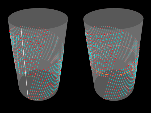

As far as hypersurface orthagonality goes, look at the diagram below. I didn't draw it, the original was drawin by another PF poster, Ibix.
Ignoring the fine points of Lorentzian geometry for now, try to imagine a line that is everywhere orthogonal to the slanted, green, vertical lines on the diagram. You can find segments of such a curve, but it isn't a closed curve. The vertical lines represent the notion of "time" on a 2 space + 1 time space-time diagram on a rotating hoop, and the curve that we asked for, one that is orthogonal to all the lines, would represent the "hypersurface" that's orthogonal to time. The problem is that the curves are not closed.
The problem becomes more acute if you consider a cylinder rather than a hoop, but it's hard to draw the needed lines clearly of this situation on a 2d piece of paper.
That's basically enough to get the idea. The hard part really is getting people to draw space-time diagrams, or to get them to look at and interpret ones that others have already drawn. While I recognize the difficutly, I don't know what to do about it .

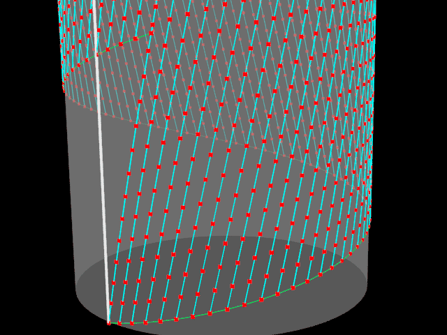

I was going to repost this myself last night, but got interrupted and forgot. The slanted lines are actually cyan. In the left hand image their bottom ends are joined by a green line, which is the line you are talking about. It is everywhere orthogonal to the cyan lines, but does not close because it forms a helix.
I can post a zoomed in view of the relevant part of the diagram later if that would be helpful. Currently on my phone and I don't have the necessary software or files.
246393
The cyan lines are the worldlines of clocks moving on a circular track, with their ticks marked by the red blobs. The green line joins one set of blobs, which is a chain of clocks each Einstein synchronised to its neighbour (in fact, if you slit the cylinder along the white line and flattened it out, the green line would be the x-axis of a frame moving at ##v=\omega r##). But this approach inevitably goes wrong somewhere - as can be seen from the failure of the green line to close.
