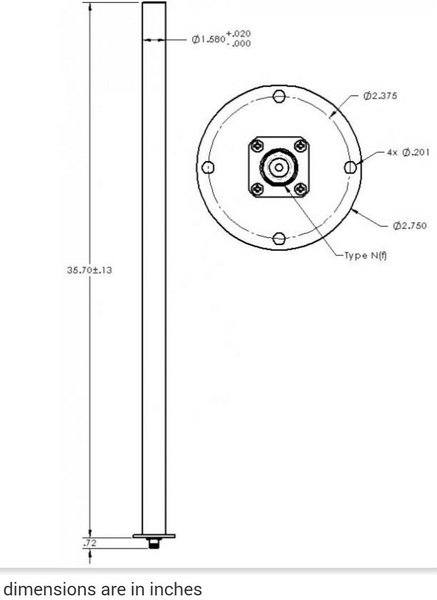

I'm curious to figure out if I'm operating a transmitter with safety compliance regarding its HERP (Hazards of Electromagnetic Radiation to Personnel).
Put simply, the transmitter has a low and high output capability of 2w and 10w. The antenna it operates on has an 11db gain. Radiating around 2000 MHz is usual here.
Things to consider, if the transmitter is on low power, but I need to physically go near it to flip the switch to the high option, am I (as the operator) in danger? What is the minimum distance I can safely be away?
Any advice on the subject is appreciated. Please let me know if other info may be required.

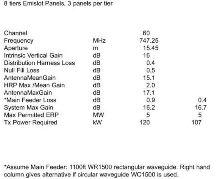

How do you get 11dBi out of an omni?
Likes Averagesupernova
Same way that big TV stations do when placed at the centre of their service area. A high vertical aperture and stacked dipoles round a mast. 11dB is not excessive.
I screen shot this info from a presentation from Alan Dick Broadcast Ltd: It has 8 tiers. Big Boys' stuff at 120kW :smile:
@OP: If the switch is below the bottom of the array the exposure would be pretty small but it is a health and safety matter so you should perhaps get hold of an RF Hazard Meter. If this is a commercial setup then you will be aware of your liability and the risks to staff and public.
yeah but we would like to specifically know how the OP is doing it :wink:
I doubt that he is using the type of antennas used for a commercial TV transmitter station
Right enough but he would only need eight stacks. For 2GHz they would be perhaps 1/4 the height of a UHF transmission antenna. and if he just used single vertical dipoles against a narrow mast, his HRP would be cardioid shape. That's practically 'omni' if you put the null where it doesn't matter. His consumer-led reception survey could well miss the null.
It would be interesting to know where he gets the 11dB figure from, though.

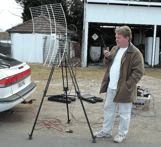

a mate and I are regularly doing amateur TV on 2.4GHz (2400MHz) with ERP TX powers of over 200W
Jack standing by his 2.4GHz antenna. We were firing the signal over 100km to another hilltop.
20W into a 20dBi gain gridpack antenna
Jack is using a 144MHz handheld for liaison to the other end of the linkDave

VivaLaFisica said:
I don't see a picture or diagram of the antenna setup in your link, but it does say this: "Collinear Dipole Array"
100km with a 5W handheld with its stock "rubber ducky" antenna -- impressive! :smile:
Must be pretty flat -- no hills in the way, right?

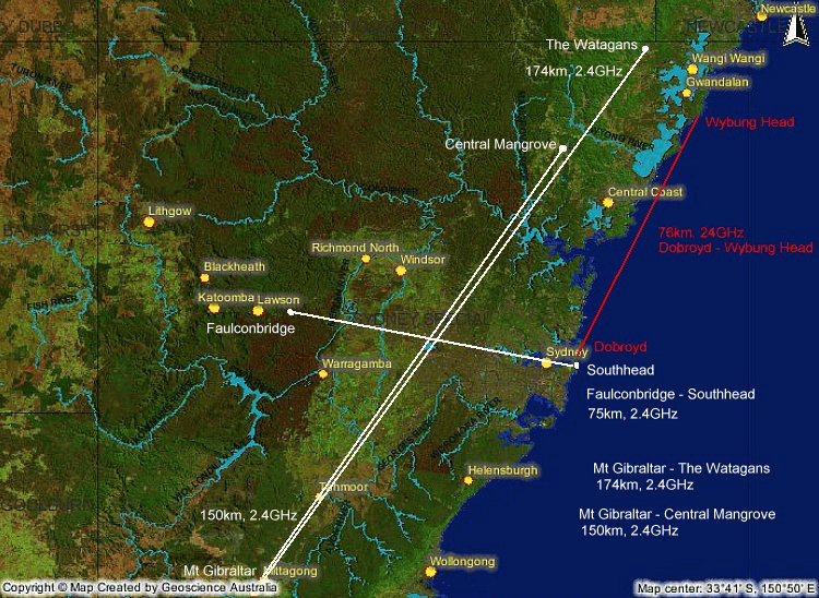

yup, line of sight, else the 2.4GHz wouldn't make it :smile:
here's some of the paths ... very hilly terrain, us guys spent lots of hours looking over maps, doing path plots etc for 2.4 through 5.8, 10 and up to 24GHz trying to find long paths
174km was my best achieved with FM ATV on 2.4 GHz
Can't remember if Jack VK2TRF and Dan VK2GG my "other partners in crime" :wink::biggrin: have done further
You can also see the red sea path that the 3 of us did on 24GHz ATV, 76km

VivaLaFisica said:
Thanks for all the input.
The antenna is something like this: https://southwestantennas.com/omni-...-array-22-25-ghz-11-dbi-flange-mount-1085-084

At this point, there isn't a standard setup of mounting the antenna. At its worst, another individual would be holding the antenna (yes, with their hand). Otherwise it'd be mounted at a height that puts the lower end of the antenna at head height.
The cables used are RG59. Maybe I'm being overly concerned, but I admit that I definitely operate within ten 10ft of transmission.

The vertical pattern of the array you have shown us is pretty narrow and I would worry about someone standing there, holding it. The main (omni) beam could end up pointing way above the horizon and also down on the crowd of users. If you have such a high end piece of kit then you really shouldn't be standing and holding it at ground level. At the very least, it should be elevated above nearby landscape features and held strictly vertical.
I can't see the point of using such an antenna if you are not making sure that it's used properly. If you are just running a transmitter test then use a simple directional antenna (yagi) that will be pointing in a known direction so that someone can do a useful remote signal strength measurement.
This is yet another example of a question that's been posted with meagre information to support it. It's frustrating for PF and it is unlikely to yield useful answers for the OP.

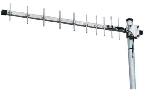

so a $500 Omni-directional antenna is a waste of money and not going to give you the directionality you need
you need yagi antennas, one at each end ... some one posted an image of one earlier in the thread ... mite have been @berkeman
You do understand that 2.4 GHz is primarily line of sight ? ... .that is, if there isn't a clear path between the 2 antennas
then you are unlikely to get a signal between them
Hope you have got a license to use this ... else you are likely to upset other users of the band

  • #35
berkeman said:
I do think that the OP should change to Yagi antennas, for the directional reasons mentioned for this application,
If an omni is not actually required, an omni is not good value. The same gain for a Yagi would mean that the VRP could be much wider and would mean that pointing would be less critical. And, of course, it is not neighbourly to spread signals in directions where they are not needed.
berkeman said:
The legal issues of unlicensed high power Tx
If this project is not totally kosher then there is more chance of getting caught if an omni is being used. But we have to assume the OP is legit or we shouldn't be having this conversation. :smile:
