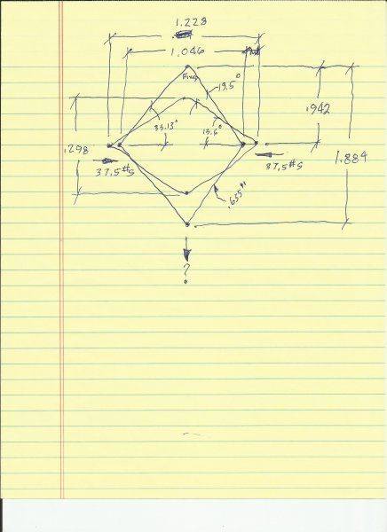

What formula would I use to calculate the lift force of a Jack Screw
when I know the force exerted on the linear screw? It would be similar to the Jack used to lift a car.
Well, you could draw FBDs for the links and set it up as a conventional statics problem,
or,
you could do some kinematics and use virtual work. Your choice!
Thanks Dr.D
Here is a FB of my linkage.
The formula you would use to calculate the lift force of a Jack Screw is the mechanical advantage formula, which is given by MA = Fout/Fin, where MA is the mechanical advantage, Fout is the output force (lift force), and Fin is the input force (force exerted on the linear screw). In this case, the input force would be the force applied to turn the screw, and the output force would be the force exerted to lift the object. To determine the specific formula to use, you would need to know the pitch of the screw, the diameter of the screw, and the coefficient of friction between the screw and the object being lifted. Once these values are known, you can use the formula MA = (π*d)/(π*p*tanθ + μ), where d is the diameter of the screw, p is the pitch of the screw, θ is the angle of the screw thread, and μ is the coefficient of friction. This formula takes into account the mechanical advantage of the screw and the effects of friction on the lift force. Therefore, by plugging in the known values, you can calculate the lift force of the Jack Screw.
