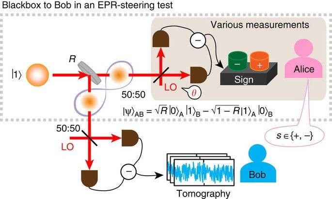

The basic setup is described with this picture from the paper (I hope I'm allowed to link this):
So simplified quite a bit, my understanding is that the procedure goes like this:
  1. A single photon is sent to Bob and Alice with a ##R=50\%## probability distribution, and hence is in the state ##| \psi \rangle = |0\rangle_A|1\rangle_B + |1\rangle_A|0\rangle_B##.
  2. Next Alice rotates her setup by a chosen angle ##\theta##.
  3. Then Bob and Alice both measure their photon steams using "full quantum-state tomography using homodyne detection". I'm not very familiar with this but I assume you can't get more than one bit of information for each photon, so it must be an aggregate of many runs.
  4. Then when their measurements are compared it can be shown that Alice's choice of measurement angle has affected Bob's results.
I'm okay with accepting the above story without grasping all the details, but my question is how there can ever be two simultaneous measurements to be compared. Binning Bob's results requires at least one bit from Alice, ##s \in\{+,-\}##. Yet each "run" consists of only a single photon; if Alice can detect anything, then surely Bob will detect nothing, and vise-versa.
If there are not simultaneous measurements by both parties, I don't see how Bob's tomography results can be binned based on the binary result from Alice, unless there is some relationship between subsequent photons.
So what's wrong with my understanding?

... my question is how there can ever be two simultaneous measurements to be compared. Binning Bob's results requires at least one bit from Alice. Yet each "run" consists of only a single photon; if Alice can detect anything, then surely Bob will detect nothing, and vise-versa.
From the reference,
"If Alice were simply to detect the presence or absence of a photon, then Bob’s measurement of the same observable will be anticorrelated with Alice's, as in ref. 42. However, this does not prove that Alice’s measurement affected Bob’s local state because such perfect anticorrelations would also arise from a classical mixture of |0›A |1›B and |1›A |0›B, in which Bob’s measurement simply reveals a pre-existing local state for him, |1›B or |0›B."
So, detecting the photon's presence or absence wouldn't do any good. Instead A and B are both measuring phase information, "homodyne detection":
"However, there is a key difference, which enables demonstration of the nonlocal collapse experimentally: rather than simply detecting the presence or absence of the photon, homodyne detection is used."
With these measurements they never find out "which path" the photon took, that info is lost. Instead they both get phase info. And Alice's decision of how to measure the phase affects Bob's measurement.
Um, I think I better read more about homodyne detection too. But I can picture how it would work if it functions as a kind of amplification.
