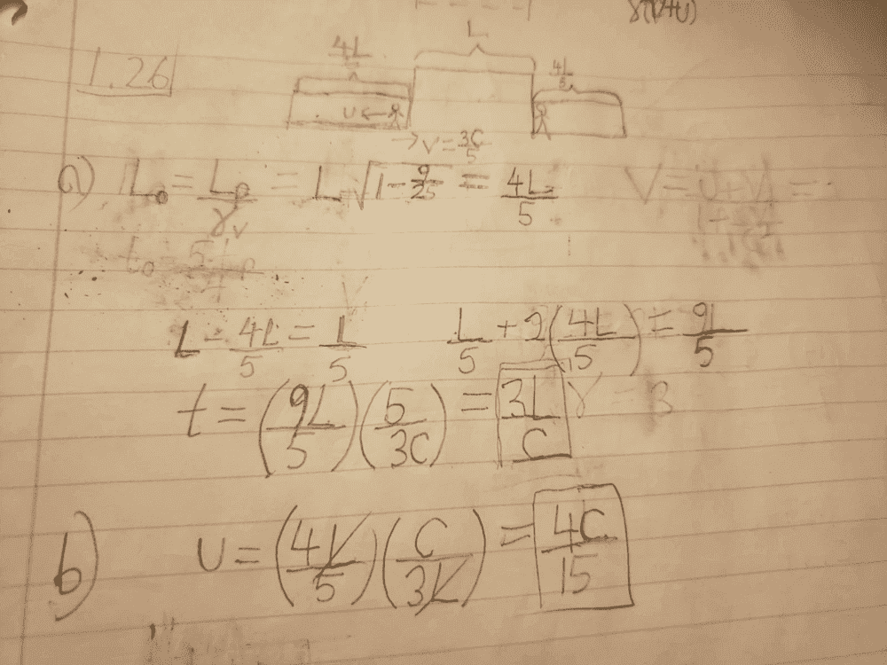

A train with proper length ##L## and speed ##\frac{3c}{5}## approaches a tunnel with length ##L##. At the moment the front of the train enters the tunnel, a person leaves from the front of the train and walks (briskly) toward the back. She arrives at the back of the train right when it (the back) leaves the tunnel.
a) How much time does this take in the ground frame?
b) What is the person's speed with respect to the ground?
c) How much time elapses on the person's watch?
$$t_{observed} = \gamma t_{proper}$$
$$L_{observed} = \frac{L_{proper}} {\gamma}$$
$$t_R - t_L = \frac{Lv}{c^2}$$
$$V = \frac{u+v}{1+\frac{uv}{c^2}}$$
I've gone back to review special relativity in preparation for GR. I apologize for the horrific handwriting.
a) So the ground frame measures the length of the train to be contracted by ##\frac{4}{5}##. So ##L_G = \frac{4L}{5}##. To calculate the total distance the train travels in the ground frame, I simply added the length of the train + length of the train + (the length of the tunnel - the length of the train). This yields ##\frac{9L}{5}##. I then divided this length by the speed of the train to get the time ##\frac{3L}{c}##, which I think is the duration for her to walk from the front of the train to the back of the train in the ground frame. Is this correct?
b) I multiplied ##L_G## by the result above which gives me ##\frac{4c}{5}##. This makes no sense; in the ground frame, the person has to be moving way faster than this. What am I doing wrong?
c) I'm not even sure what this question is asking. Does it want me to find the reading of her clock in the ground frame? I'm guessing I use time dilation then.
Thank you.
Your answer to a) is correct.
For b) what is the person's motion relative to the ground?
For c) you want the proper time of the person (i.e. the elapsed time on her watch).
For part b):
She started walking when level with the start of the tunnel.
She finished walking when level with end of the tunnel.
So (in the ground frame) she has moved the length of the tunnel - a distance L - in the time calculated in part a). This gives her speed relative to the ground.
For part c), remember her clock is running slower than the ground clock by a factor [itex]\gamma [/itex] where [itex]\gamma [/itex] is a new value to be calculated using her speed from part b).

b) I see. I simply hadn't finished the problem. I still have to plug ##u## into ##V = \frac{u+v}{1+\frac{uv}{c^2}}##. That gives me ##\frac{75c}{189}##. Is that right?

I'm confused. @PeroK says part c wants the proper time. But you're saying it wants the time on her watch in the ground frame. Which one is it?
That's not what i get. Why use velocity addition? See post #3.
The time shown on her watch is invariant. All frames agree on that. That is her proper time - in every frame.

Oh, so it's simply ##\frac{c}{3}##? I just divide the length of the tunnel by the time in part a. That actually makes more sense. I don't know why I was using the contracted length of the train.

Ok, so then ##t_{observed} = \gamma t_{proper} = \frac{t_{proper}}{\sqrt{1 - \frac{1}{9}}}## -> ##\sqrt{1 - \frac{1}{9}} t_{observed}## = ##\frac{2\sqrt{2}}{3} t_{observed} = t_{proper}##. And I just plug the time from part a into ##t_{observed}##, right?
Yes, the watch is moving at ##c/3## relative to the ground frame. It started at one end of the tunnel and moved to the other. The (proper) time shown on the clock is time-dilated in the ground frame.
