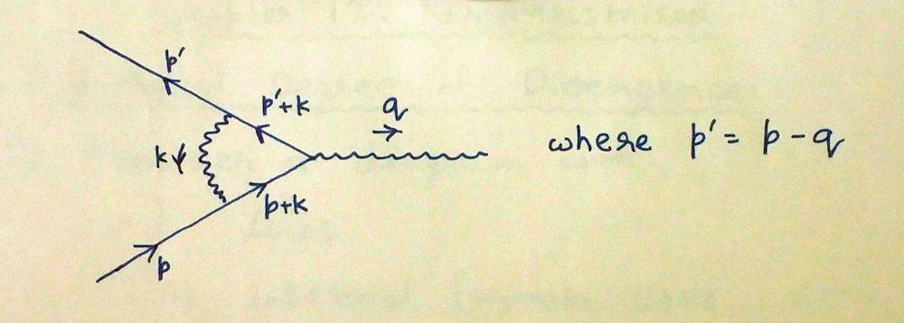

The main Feynman diagram that will be used is this one:
Fig. 1

2. Consider Fig. 1. The vertex function for the above diagram is:​
245940
Eqn. 1
where ##eQ## is the charge of the particle, and the superscript on ##\Gamma## denotes the number of loops.​

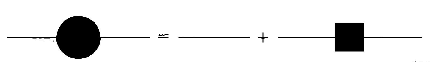

The authors have said, "Let us first draw the total 2-point amplitude as the sum of the tree-level and the rest." And they have given the following diagram:​
245942
Fig. 2
The undecorated line on the RHS is the tree level diagram.​

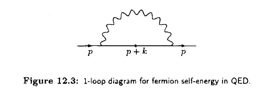

Next, consider this diagram (from the attached pdf):​
245941
Fig. 3
The contribution of this diagram can be written as: $$-i\Sigma^{(1)} (p) \ = \ (-ieQ)^2 \int \frac{d^4 k}{(2\pi)^4} \gamma_\mu \dfrac{i}{\not\! p + \not\! k - m} \ \gamma_\nu \ i D^{\mu \nu} (k), \quad \text{...Eqn. 2}$$ where ##iD^{\mu\nu}## is the photon propagator.​
After some manipulations, what comes out is, $$q^\mu \Gamma_\mu ^{(1)} (p,p') \ = \ Q \left[ \left(-\Sigma^{(1)}(p)\right) - \left(-\Sigma^{(1)}(p')\right) \right] \quad \text{...Eqn. 3}$$ Then they wrote, "Adding this (Eqn. 3) to the tree level relation gives Eq. (12.13) up to 1-loop contributions." (I have highlighted this line in the pdf.) This is Eq. 12.13, the Ward identity: $$q^\mu \Gamma_\mu (p, \ p - q) \ = \ Q \left[S_F^{-1}(p) - S_F^{-1} (p - q)\right]$$ where ##S_F## is the fermionic propagator.​

I just couldn't understand what they are saying above. What is "tree-level relation"? This one?
The tree level relation is simply ##-ieQ\gamma^\mu##. What he's saying is you dot this with ##q## and then rewrite it to something like $$-ieQq_\mu \gamma^\mu = -ieQ(q_\mu + p_\mu - p_\mu)\gamma^\mu -ieQ(m-m), $$ then when you add this to equation 3 it works out. Mind you those ##S_F## terms in Eq. 12.13 aren't the free propagators but rather the effective QED ones:
$$S(\not\! p) = \int \frac{d^4p}{(2\pi)^4}e^{-ip(x-y)}\langle \Omega |T \psi (x) \bar\psi (y) | \Omega \rangle = \frac{i}{\not\! p - m +\Sigma(\not\! p)},$$
from this you can see that ##S^{-1}(\not\! p) = -i(\not\! p - m +\Sigma(\not\! p))##. My signs and placement of ##i##s might not agree with your textbook by the way, so interpret them as you may.
