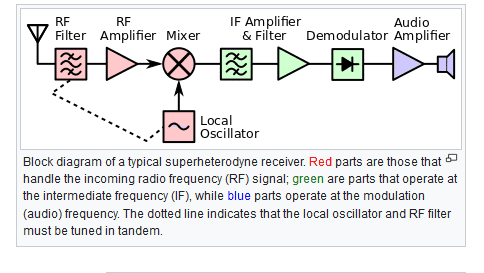

the concept is precisely that of the signal mixer in which the external radio signal is made to interfere with an internal wave, I cannot explain it well I am sending you some references
I replied to your PM. You cannot demodulate the information signal from the carrier signal without using transistors and/or diodes. You need the non-linear circuit elements in order to perform the "mixer" and "demodulator" functions in a receiver.
https://en.wikipedia.org/wiki/Superheterodyne_receiver

I already linked to the English Wikipedia page about demodulation and mixers.
Anyway, if your professors at university are letting you spend time on exploring how a linear system (the human body without any circuitry aids) can demodulate any form of modulation (ASK, AM, FM, OOFDM, etc.), perhaps they want you to realize that it is impossible, and explain why it is impossible in your paper.
