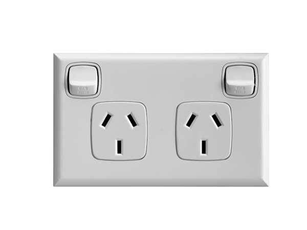

I don't know what country you are from ? ... but that's pretty restrictive ... does that mean you cannot have double outlets, like we do here in Australia and New Zealand
I am not aware of any minimum spacing requirements in our two countries. The sockets are places where needed.
Along a workshop workbench like mine I have 3 double outlets within an 8ft workbench length
