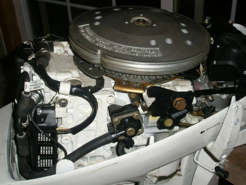

Ok guys I have a stator/alternator on one of my motors, and the thing finally gave out on me. You can tell where the wire got hot and burnt through the insulation. I have heard that you can use thinned down JB weld as a good insulator. How important is it that the insulation be the same resistance value as it is factory? Would a variance change the amperage sent back from the charging system? Thanks guys!
With wire
Fried insulation

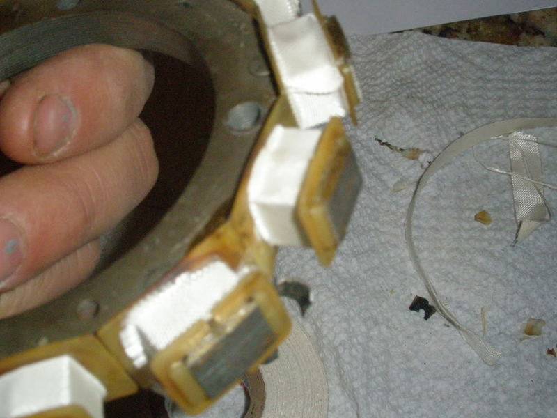

Thanks for the reply Jim. The wire has already been removed, and now I have a fresh roll of laminated magnet wire. The plastic that kept the wire apart from the armature is what I want to replace. Are you thinking a layer of high temp metal paint or varnish around the armature? I have had some suggest, that since I have high temp insulated magnet wire, to simply wrap the armature with the fresh wire and call it a day. What would you do??
I've had trouble with the sharp corners of an armature getting through the varnish and shorting a brand new winding.
I'd cover the armature with something to make a softer bed for your new windings.. Scotch 27 is a stout fiberglass electrical tape that'd be good.
Alternative is wind each coil on a wood form just slightly bigger than armature, then slip it over the armature and bed it in your JB weld.

Photo looks like they wound their coils on nylon forms. Can you salvage those?
They sure did Jim. Some of the nylon forms are burnt all the way through. That is why I was thinking of just wrapping some insulating tape around them and then the wire. I just don't want to alter the properties of the stator.

Gotcha but should I just stick it to the old nylon caps or straight to the metal?
I'd wind the wire right over whatever nylon bobbins are still in good shape.
Where they're destroyed try to make something from your tape that serves the same function, protecting your wire from the iron corners.
After it's wound check with ohmmeter to verify it's not shorted to metal armature, then soak all the windings good with varnish so the wires don't vibrate against one another.. (that'd abrade the factory varnish which is probably Formvar, a tough varnish for magnet wire insulation )
It's more of a mechanical matter than electrical.
Objective is to get the wire in place treating its thin insulation as gently as possible, then secure it.old jim

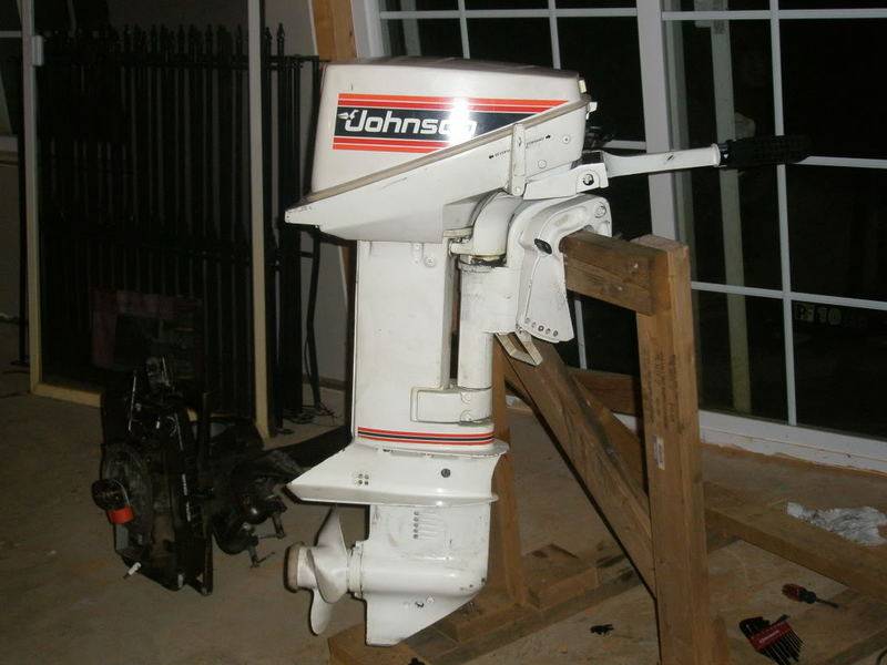

It goes on my 1967 65hp Mercury Outboard.:cool:

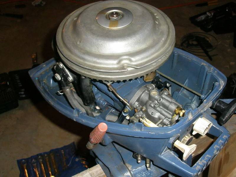

Ahh i love vintage outboards. But I'm an Evinrude guy. Have a 56 Fleetwin 7.5 and a coiuple old 10hp projects.. am getting good at adapting modern fuel pumps to those old dual-hose pressurized tank style motors so you can use new tanks.
Under flywheel where your stator lives shouldn't be terribly hot. I was worried it was in motorcycle primary chaincase or something.
I should send you my 6hp Evinrude to upgrade. :biggrin:
Clearly off topic
but you run across bargains in fifties-vintage motors because of the pressure tank issue.
Make a mountng bracket for modern pump. Drill it and partway through and install a tube to connect to actuating pressure port, the hole in center.
Underneath reed valve cover remove ONE of the poppets that feeds the old pressure port and block the other. I use a piece of gasket paper.
Old pressure port is now the pulsating pressure you need to operate modern fuel pump.
I mount the bracket to rear housing support where it's out of the way. Most recent conversion was a friend's '55 Johnson 5. Used 3/8 aluminum plate for bracket.
Those old 'rudes have the intake silencer and are quietest smoothest longest-lasting outboards ever built. Sailboat guys crave them for auxilliaries. I see your 6 is longshaft...

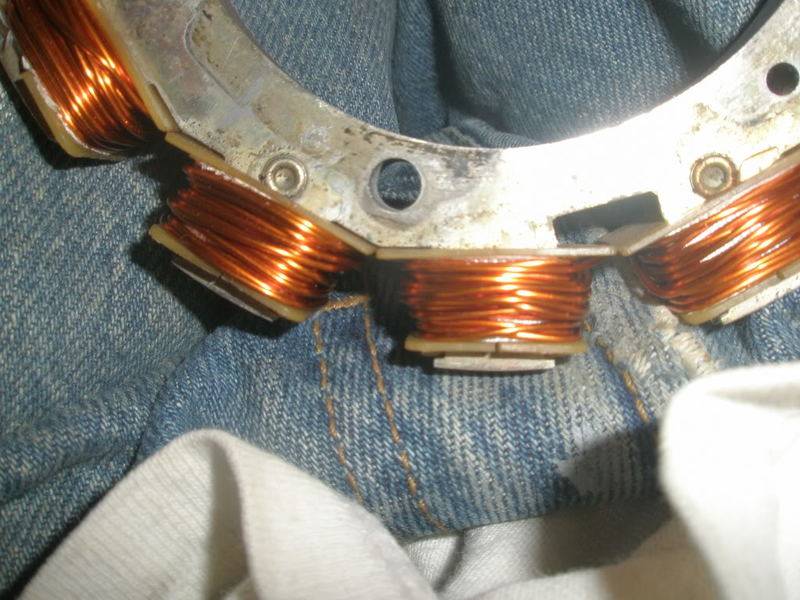

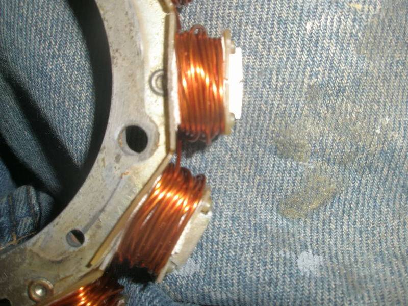

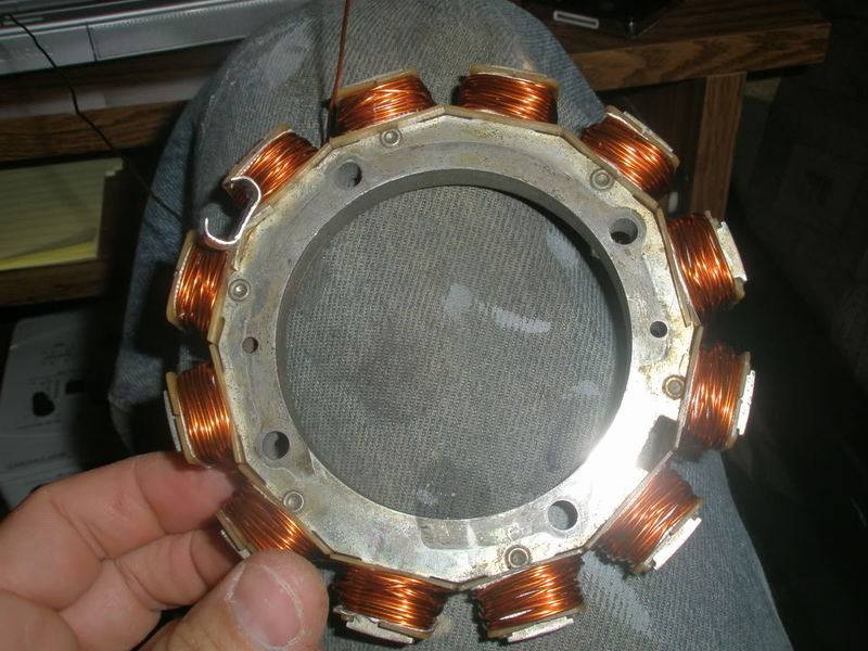

Okay Jim, I finally got my scotch 27 in, and re-wired the stator. Now keep a few things in mind. What I did was keep the nylon because I felt like it held the wires on tight, and I just wrapped them with scotch 27. See photos. Also, when I rewound the coils, I got them as tight as I could, but the wires didnt wrap as neat tight as they did from the factory. How important is this? I have plenty more wire if I need to just bite the bullet and rewind it. I made sure to count the wraps, and follow the wrap pattern. Thanks for your input and support!
That looks to me like an excellent job.
Tightness of wraps will not make much electrical difference at all.
Biggest reason for tight wrap is to keep wires from vibrating against each other and wearing through their varnish insulation. This is what - a ten amp alternator? Not very much force on them. I believe you'll be fine.
Check it with ohm-meter to make sure nothing's shorted to metal
then try it out .
Nice looking work !
Perhaps apply a little 5 minute epoxy or even spray varnish over ends of tape so they don't fray or separate?

Thanks Jim, glad to hear it! Not much amperage at all, just enough to keep the old 12v battery up and charged. I didn't spend a whole lot of time on her, but I did try and wrap it as tight as I could. I will pull the flywheel after a few hard runs and make sure stator isn't getting hot in any spots. Worse case scenario is I burn something up and re-wrap her ay? But I will check for shorts, check my resistance, and let you know in about a week or so what type of current I am getting back at my battery when I get the motor back up and running. Thanks again for all of your experienced advice.
Okay Jim, ran the motor today for the first time in over a month. She ran great. I checked the voltage at the battery, and it read 12v. Started the motor up, and at idle it read 12.8v, and at about 1500 RPMs it read 13.5v. So I am good to go! The stator should charge just fine. Thanks again for all of your help. :)
Very heartening news ! She's charging indeed .

Your first couple of pictures look like a stator that's been fried by a failed rectifier-regulator module.
When the internal diodes short out it let's the battery discharge through the alternator windings and fries them. After battery runs down they cool off.
I am guilty of ASSUMING you checked for that.
If not, here's what i would do:
Remove positive battery wire .
Connect a 12v lightbulb between the wire and battery post . If it lights current is going someplace.
If so, disconnect the alternator winding (unplug plug or lift wires) . If that extinguishes light , current is making its way backward thru regulator and it'll likely fry again.
If it's dark you can just look for small spark at terminal.
Seems obsessive-compulsive i know, and i do suffer from that, but it's such an easy check with such potentially significant result.. I use the $2 test probe from walmart, looks like an illuminated ice pick with wire attached.
You probably did it already. as i said I'm ocd.
