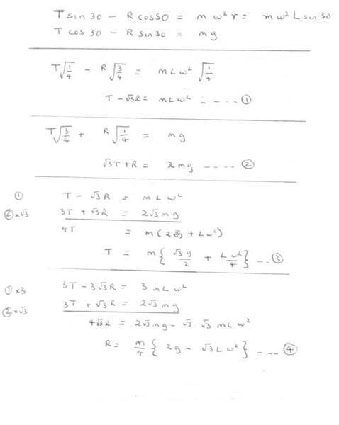

Apologies, the string is 2m long and the mass is 2kg.
  • #55
Studiot said:
Well this is the danger of being entirely theoretical.
If anyone did a calculation they would find that there is no normal force.
Actually, there is no possible way to set up that experiment where the normal force will be precisely zero (even if all the necessary information is included), because of one more force on the mass-- air resistance. That will require a small normal force to allow for the balance between air resistance and static friction. All this means is, if you try to spin the cone too fast, no steady-state solution will be possible, so any steady state requires a nonzero normal force. The "zero normal force steady-state solution" is an idealized situation that is impossible to achieve in practice if the motion of the mass will be due to the spinning cone.
But even that doesn't matter-- the prescription for calculating constraint forces allows them to be zero, it is not any kind of bother when they come out that way in idealized problems that do contain all the required information.
The real question is: what does this have to do with erroneous statements about what inertial forces are?
  • #56
With those values the normal force is actually negative 9.9 N. I.e. 9.9 N inwards. I assume this is unintended.
  • #57
Yes, I get that omega^2 * L can never exceed g / cos(theta) with that kind of setup, where L is the length of the string. Here 1/cos(theta) = 2, so omega^2 * L must not exceed 19.6 m/s2. Here it is 22.8 m/s2.
  • #58
Mentor note:
This post, and several that follow, were made in another thread. There were moved to this thread because this thread is where discussions of this problem belong.
Why don't you write again the complete question in one post, give us your two solutions (inertial frame, co-rotating frame with fictious forces) and show us how the later "will definitely get you the wrong answer"?
Why?
Well first point is that both D'Alembert's and Newton's methods will lead to an invalid conclusion if inappropriately applied.
The question was specifically constructed (not by me) to demonstrate the particular point that it is posible to step outside the obvious assumptions and thereby obtain the 'wrong' answer.
Unfortunately instead of having an adult discussion about Physics I felt I was being personally attacked in the other thread.
The relevant equation, by either method, is
[tex]R = 4.93 - \frac{{\sqrt 3 }}{4}{\omega ^2}[/tex]
I make the ω at which R becomes zero the 3.374 I posted.
Various values for R, including negative ones were offered, but none if I recall correctly equal to zero.
Whirling beyond this speed simply causes enough tension in the string to lift the mass of the cone.
Of course R remains zero or is non existant. It surely is never negative.
  • #59
The problem stated that the mass was attached to the cone. Therefore the mass could not lift off of the cone and the normal force could become negative. Of course, the problem did not specify the method of attachment so in all likelyhood the problem was either inconsistent or overdetermined.
Zero was not correct.

That looks interesting, but I don't know that topic and the calculations are missing... Do you by any chance have a reference?
  • #64
At last someone with some good manners and an open mind.

  • #66
Ken G said:
It appears from your diagram that the mass is suspended from a string, and lies against the cone. If so, there are three real forces on the mass-- the tension from the string (which points along the string), gravity (which is downward), and the normal force from the cone (which is perpendicular to the cone surface).
You are talking about a tetherball physics problem. That is not the correct setup for this problem.
The cone would be a meaningless complication were this the correct setup; you might as well just have a vertical pole. The angular displacement of the string from the vertical for tetherball rotating at 3.374 rad/sec and at a distance of 2 meters from the pivot point would be 64.58 degrees assuming g=9.80665 m/s2. However, the surface of the cone is displaced only 30 degrees from the vertical. What is the correct setup? Studiot said, emphasis mine,
Studiot said:
A (point) mass m is attached to a smooth cone of 60 angle.
Here "attached" essentially means "bolted to". Attached where? He didn't say. He later did say "2 m", but measured with respect to what, and along what line?
Studiot, when you are specifying a problem, you need to be very specific about the setup and about what quantities are to be found. Along what line is that "2 m" distance measured? Is gravity in the picture? Do you want the forces acting on the point mass by the attachment mechanism resolved into normal and tangential components? You didn't specify any of these. We can't read your mind.
  • #67
Studiot said:
The mass is not attached to the cone by adhesive which would be needed to obtain a negative reaction force.
It is attached by the string which would be unecessary if adhesive were to be used.
None of that was specified in the problem. This is Physics Forum, not Psychics Forum. You cannot post an inconsistent or incomplete problem and then claim failure of some analysis technique by the resulting "mistakes". The question itself was bad.
Also, you don't know if I did the analysis in a rotating frame or in an inertial frame. As it happens I did the analysis in an inertial frame. Shall we therefore reject inertial frames?
  • #68
Studiot said:
[Dynamics 4.2]
I suppose that that is of the same book that you cited before?
About your calculation example: [moved to thread where that comment belongs!]
I agree with the terminology there, as I see no reasonable alternative to calling the reaction force due to inertia "inertial force" - as it surely also has been called in physics from the start. NewSpeak is evil. :wink: But since that expression has been hijacked to mean something subtly different, it is necessary to clarify when the implied meaning is the proper, original meaning. That's all that I'll say about that. The day will come that we'll have to clarify when we mean a small animal with "mouse". :biggrin:
Harald
  • #69
I would very much like to see the previous page with the problem description. I suspect it is much more complete than your rendition.
  • #70
Please.
The attachment in that post does not contain the problem setup. However, there enough information is supplied so as to reverse engineer the problem. The values 4.93 and 4.93√3 in equation (iii) respectively represent mg·sin(θ) and mg·cos(θ), where θ is 30 degrees. Presumably these values have units of Newtons. From this, and using g=9.80665 m/s2, one can deduce that the mass is 1.00544 kg. That is a goofy value for a textbook physics problem, but it is easily explainable by looking at the value 4.93. I'm going to assume that this is a typo. A value of 4.903 yields a nice value of 1 kg for m.
What about r, and what does it represent? The values ω2/4 and √3ω2/4 in equation (iii) respectively represent mrω2sin(θ) and mrω2cos(θ). From this, and using the previously reverse engineered value of m=1 kg, one arrives at r=1/2 meter. (The value is something different if the value of 4.93 was not a typo.) Finally, from the free body diagram, it is obvious that r is the distance between the axis of rotation and the point mass. For a point mass attached by a string to the apex of a cone with a half angle of 30 degrees, one can deduce that the length of the string is l = 2r = 1 meter.
Try again. I don't want you to show the pages from that book that describe the setup; we're bordering on copyright infringement in this thread as it is. You can describe the setup for us. Take great care in doing so; you did not describe the problem well before.
