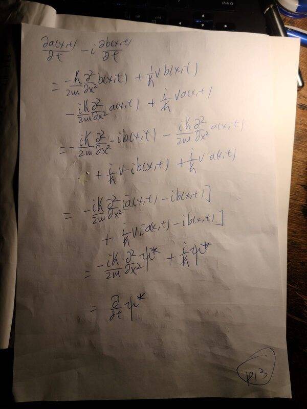

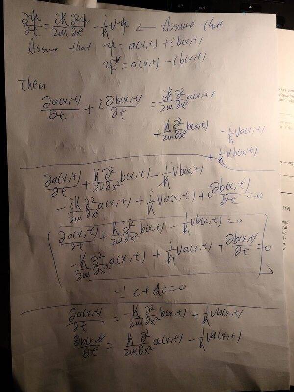

I have asked one of my frds from math department and obtained the following proof. Forgive me for uploading only two piece of paper because I would like to spare my effort in typing latex.
I do not understand why taking the complex conjugate seems so intuitive and obvious to you guys.

That's far too long winded. All you really need to show (if you don't already know this result) is that: $$(\frac{\partial \Psi}{\partial t})^* = (\frac{\partial \Psi^*}{\partial t}) \ \ \text{and} \ \ (\frac{\partial^2 \Psi}{\partial x^2})^* = (\frac{\partial^2 \Psi^*}{\partial x^2})$$ And the rest follows from taking the complex conjugate of an equation.
The point being that by the time you come to study QM, you shouldn't need to prove that, say, ##(z_1z_2 + w)^* = z_1^*z_2^* + w^*## from first principles. That's a basic result from complex numbers that you should know and apply without further ado.
If you are learning complex numbers for the first time, then it's a different matter, but Griffiths will expect you to know at least the basics.
Likes sysprog, vanhees71 and Tony Hau
Sorry, but "I would like to spare my effort" is not a valid excuse. PF rules require equations to be typed directly in the post using LaTeX. If you want discussion of the equations, you need to type them in.
