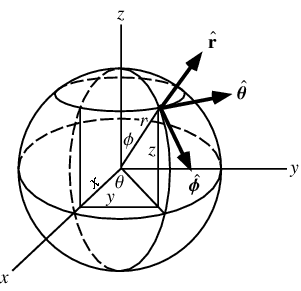

We often draw the unit vectors inside the Euclidian space, like this:
However, if the unit vectors are dimensionless, why does it make sense to draw them on the diagram? That is to say, how do you judge how long a length of a "vector of magnitude 1 (dimensionless)" is?

Maybe I was wrong to consider the length dimensionless, and the unit vector shouldn't have one and it is a pure direction. Then the solution of the paradoxon is that it only regains its dimension if drawn, i.e. we actually draw ##\dfrac{\vec{v}}{|\vec{v}|}\cdot |\vec{1}|## where ##\vec{1}## carries the units of our drawing.

Then the solution of the paradox is that it only regains its dimension if drawn, i.e. we actually draw ##\dfrac{\vec{v}}{|\vec{v}|}\cdot |\vec{1}|## where ##\vec{1}## carries the units of our drawing.
I see! That makes sense. Thanks!
The appropriate length of the unit vector is determined not by the vector nor by the pencil but by the paper...:smile:
Or short: You cannot draw pure direction.
Likes etotheipi
