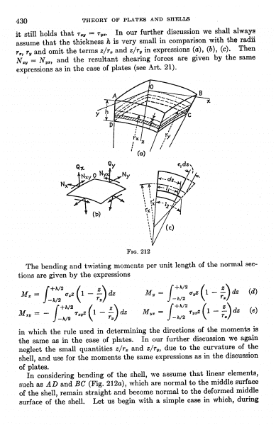

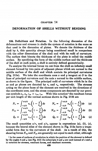

I do understand the assumptions involved in membrane theory for designing a thin concrete shell structure. But i do not follow the derivation of it. I am doing my masters in structural engineering and I have never had classes in deferential geometry before.
( The following pages are not subject to copyrights.
  1. Theory of Plates and Shells by Stephen Timoshenko
  2. Published: 1940 )
why does the normal forces ,shear forces (pg 429 )bending and twisting moment have the term (1 - z/r) (pg 430)

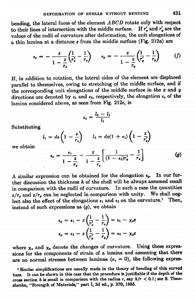

Can you please explain pg 431.

Before tackling Timoshenko, let me suggest that you look at Den Hartog's Advanced Strength of Materials, McGraw-Hill, 1952, Ch III, "Membrane Stresses in Shells." On p. 78, Den Hartog addresses a spherical tank design problem, so this might be particularly relevant.
Specifically to your question from Timoshenko, "why does the normal forces ,shear forces (pg 429 )bending and twisting moment have the term (1 - z/r) (pg 430)," the answer is that Timoshenko is expressing the variation the stress through the thickness of the shell, much like assuming a linear variation of strain and stress through the depth of a beam in ordinary beam theory.
