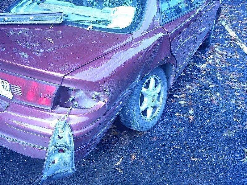

Now, I had a collision approximately two weeks or so ago, however, I was the one blamed for the collision due to a "witness" but I need some help with the correct calculation I need.
You see, her car weighed 2602 pounds, where as my car weighed 3359 pounds, but she hit me hard enough on the back right wheel to end up not only denting my car a fair bit(several things bent in fact), but she ended up spinning me approximately 300°, while her car slid about 50 ft after she hit me.
The only thing I can figure out is that she must have been going way to fast, I mean I could be wrong, but I would very much like to know.

It's not that I even really want to prove to my insurance company, I just want it for me really, like I doubt walking in their with an equation will turn the claim around like that. But I find it annoying that the person who hit my car even told me that she thought, and I quote " I hope I don't hit him" , she even said to me that she "closed her eyes".
The place of the collision was a two way intersection through a stretch of road, all normal asphalt, she collided with the back 2 ft or so of my car with the front end of her dodge neon. It just seems to me though, that in order fer her car to slide an extra 50 or so feet she would have had to been going more than the speed limit at 35 mph.
Here are some pictures that I took

These pictures don't really help with an analysis of the collision and as Simon said there's nothing that we can say that would support your case. If you
hire a lawyer then yhey may be able to have an accident reconstruction specialist do the numbers and be an expert witness for you.

Crude approximation, but here we go:
I assume the car is sliding and the tire friction coefficient for sliding can be assumed to be 0.75. So if you see 50 ft of skid marks (using [itex]v = \sqrt{2\mu gd}[/itex]), that means that she was going 33.5 mph when she started to skid. Thus, using [itex]E = \frac{1}{2}mv^2[/itex], the car had 132.34 kJ of kinetic energy.
For the energy required to spin your car, let's assume you have a wheelbase [itex]L[/itex] of 105" and your rear tires (and half the weight of your car sitting on them) slide with the same CoF of 0.75 for 0.833 turn (= 300°/360°). That requires 78.27 kJ of energy (using [itex]E = \mu mgd[/itex] and [itex]d = 0.833\times 2 \pi L[/itex]).
Adding both (210.61 kJ) and using [itex]v = \sqrt{\frac{2E}{m}}[/itex] means that the car was going at least 42.3 mph before hitting your car.
Values in every equation must be in SI units (I did all the conversion).
Again, crude approximation. It could be lower or higher, but I doubt it would be less than 35 mph.

regular tyres on dry asphalt: sliding friction 0.9, rolling resistance 0.011
http://hpwizard.com/tire-friction-coefficient.html (and elsewhere)
s=15m sliding from the collision to rest, suggests
##\mu mgs## went into the ground while sliding.
That puts the speed after the collision at: ##v=\sqrt{2\mu gs} = 11.5m/s##
... so she was, easily, going faster than 26mph before the collision.

A somewhat messier back-of-envelope that accounts for the engine being at the front of the car, so center of mass is more forward making it easier to rotate by pushing on the back, and some notes about accident studies, I get about 60kmph for the ballpark speed before the collision.
60-70kmph sounds like about the right range ... this is a common type of accident.
There are quite a few examples of collisions at this speed-range online.
Many people think that 35-40mph is slow ... and then get surprised by the damage.
