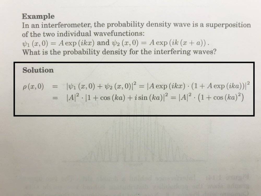

##\Delta p \Delta x \geq \frac{h}{4\pi}##

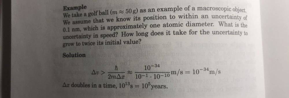

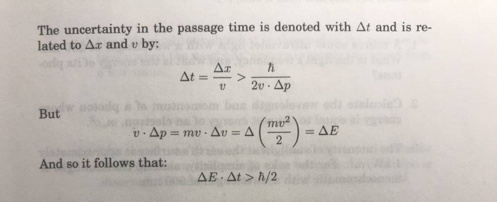

1.jpg Is the last inequality correct? Should it not be ##|A|^2 \cdot 2(1+\cos{(ka)})##?2.jpg How is the time calculated here? Given ##\Delta v > 10^{-34}##...3.jpg How come ##mv \Delta v = \Delta (\frac{mv^2}{2})##? Where does the ##(1/2)## come from?
1. You are correct. Book solution is a mess
2. It's your homework: what's the relevant equation here ? (hint: see 3)
3. Simple differentiation

I must be honest, I don't buy this "uncertainly in the passage of time". What on Earth does that mean?
The Δt in the time-energy uncertainty relation is the time it takes the system to change in some defined way.
In QM, time is a parameter about which there is no uncertainty as such.
It's an 'order of magnitude' exercise :rolleyes:
Regarding 3, ##mv \Delta v=\Delta (mv^2)##, but where does the last equality follow from?
If you extend that notion of a differential to a derivative, with respect to time, then all should be clear.
Likes schniefen
Why would ##\Delta t > \frac{4\pi(\Delta x)^2}{h}## give the time it takes for ##\Delta x## to double? Where is the factor ##2\Delta x##?
The logic is that the uncertainty in ##x## has an associated minimum uncertainty in momentum, hence energy; and you apply the energy-time uncertainty relation.
Have you tried that?
The logic is this. You start with an uncertainty in ##x## in the classical sense. You apply the HUP to get an uncertainty in ##v##. You interpret this as a classical uncertainty. You multiply the uncertainty in ##v## by ##\Delta t## to get a further, classical, uncertainty in ##x##.
You want to find ##\Delta t## where the additional uncertainty in ##x## equals the initial uncertainty.
