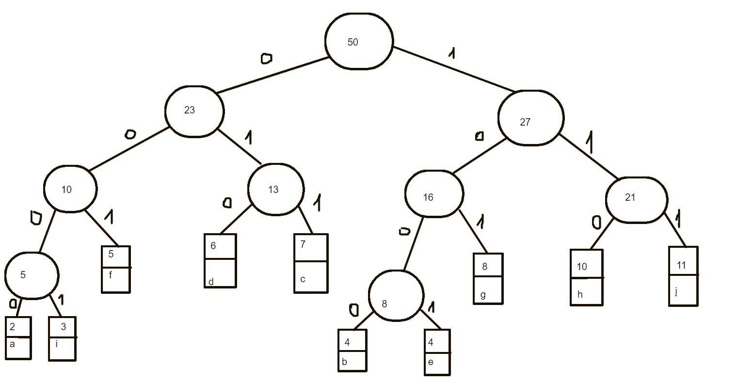

We are given the following letters with the respective frequencies:
\begin{equation*}\begin{matrix}a/2 & b/4 & c/7 & d/6 & e/4 & f/5 & g/8 & h/10 & i/3 & j/11\end{matrix}\end{equation*}
For that I have applied the Huffman code and I got the following tree:
Now it is asked for the total weight of the code. How do we calculate that? :unsure:

Hey mathmari!
The total weight would be the weighted path length from the root.
The objective of the algorithm is to minimize the total weight, implying that compression is optimal. 🧐
Put differently, it is the length of the resulting code for each symbol multiplied by its frequency and then summed together.
So the contribution of $a$ is $4\times 2=8$, since $a$ is encoded by $0000$, which has length $4$ and it occurs $2$ times. 🤔
I think your tree is not optimal though. I found a different tree with a slightly lower total weight. (Sweating)
