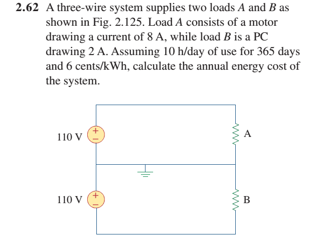

Two voltage sources and two loads, how to approach this one
In summary, the conversation discusses the application of KVL for two loops and calculating the power consumed by each appliance. The concept of zero potential and polarity of voltage sources is also mentioned. The conclusion is that potential difference is what matters, not the chosen side for zero potential.
kostoglotov
234
imgur link: http://i.imgur.com/G9RKEH1.png
[/B]
Should I just consider that A and B are parallel with each voltage source respectively and so therefore that's the voltage drop that they experience individually?
The ground terminal should be zero volts, no? Wouldn't that mean the polarity of the bottom voltage source needs to be reversed?
You could try applying KVL for both the loops and obtain something you'll need to calculate the power consumed by each appliance
I'm not completely sure about this though.
Seems right to me.
Zero potential is a convention. What matters is potential difference. The PC does not care which side you choose to call zero.
