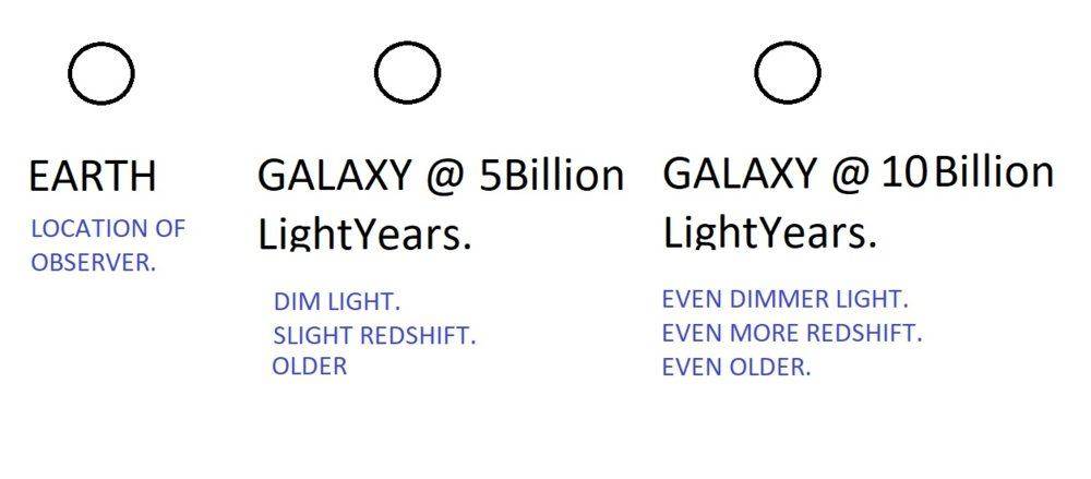

I have made a very crude sketch to illustrate what I am asking. (Sorry for the quality)
I will have follow up to this after I get some feedback first. I am going somewhere with this.
Thank in advance.

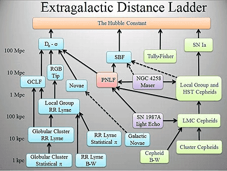

You should be aware that there are quite a few overlapping methods for determining distances. Each one has a range of error, but when comparing them the error is dramatically reduced until we're pretty confident in our numbers.
It's called the ladder approach to cosmic distances.
Have a read:
https://en.wikipedia.org/wiki/Cosmic_distance_ladder
Likes pinball1970, Klystron, QuantumQuest and 2 others

Also, do you see an issue with the crude picture? If so where? ("OLDER" and "EVEN OLDER" in terms of the time the photons took to get to earth, not the absolute age of the galaxy)
