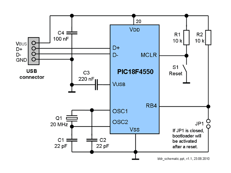

Ah... To get started you will need an external programmer. I use the PicKit-2, which I think has been superseded, but it was not very expensive anyway. It connects to an In-Circuit-Serial-Programming (ICSP) connector, so you don't have to swap the PIC chip from place to place. Once you get going you can probably find some boot-loader that would allow you to program over the USB itself.

http://www.diolan.com/pic/bootloader.html

Reading the edaboard page it seems that the writer used a "JDM programmer" to get something on the PIC. Googling that, turns up a socketed programmer board, so I guess they plugged their PIC into that and got it programmed and then put it on the minimal board that they built.
I'd guess that you might be able to use the JDM to get a bootloader onto the PIC initially and then figure out how to upgrade via USB. My preference would be to get the PICkit ICSP programmer and use it for upgrades as well, but that's just me...

Your schematic looks like the basic idea for getting a PIC and USB port going, presuming that whatever boot-loader you use looks at RB4.
