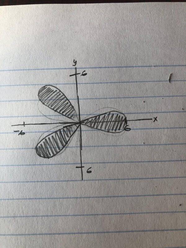

I encountered a question which asked me to describe the rose petal sketched below in polar coordinates. The complete answer is
R = {(r, θ): 0 ≤ r ≤ 6 cos(3θ), 0 ≤ θ ≤ π}. That makes sense to me for the right petal. What about the other two on the left?

##r(\theta + \frac{2\pi}{3}) = r(\theta)## since ##r## is periodic at ##\frac{2\pi}{3}##, so once you have drawn one petal you can insert the rest
Likes berkeman
Wait, I don’t understand, how’d you determine that?

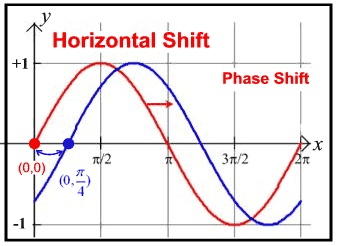

There are two ways you can think about it. Consider the function ##r = 6\cos{(3\theta)}##. If we consider some angle ##\theta_0## where ##r(\theta_0) = r_0##, then we see that$$r \left(\theta_0 + \frac{2\pi}{3} \right) = 6\cos{\left(3(\theta_0 + \frac{2\pi}{3})\right)} = 6\cos{(3\theta_0 + 2\pi)} = 6\cos{(3\theta_0)} = r(\theta_0) = r_0$$which means that both ##\theta_0## and ##\theta_0 + \frac{2\pi}{3}## correspond to equal radial coordinates. The other way to look at it is what I think @berkeman was suggesting, i.e. consider transforming the original function by a constant translation,$$r_2(\theta) := r(\theta + \frac{2\pi}{3})$$so ##r_2## is shifted left of ##r## by the amount ##\Delta \theta = -\frac{2\pi}{3}##. But the periods of both ##r## and ##r_2## are equal to ##\frac{2\pi}{3}##, so we've just shifted the waveform left an entire period. Since ##r## and ##r_2## are then equal everywhere, we have$$r(\theta) = r_2(\theta) = r(\theta + \frac{2\pi}{3})$$And finally, what amounts to a horizontal shift in ##r## vs ##\theta## on Cartesian axes corresponds to a rotation in polar coordinates!
