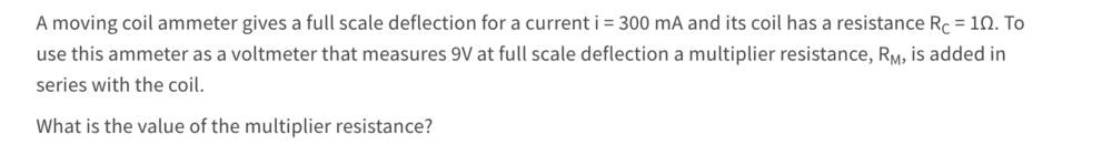

Work out value of multiplier resistance
See below
This is the problem itself shown below

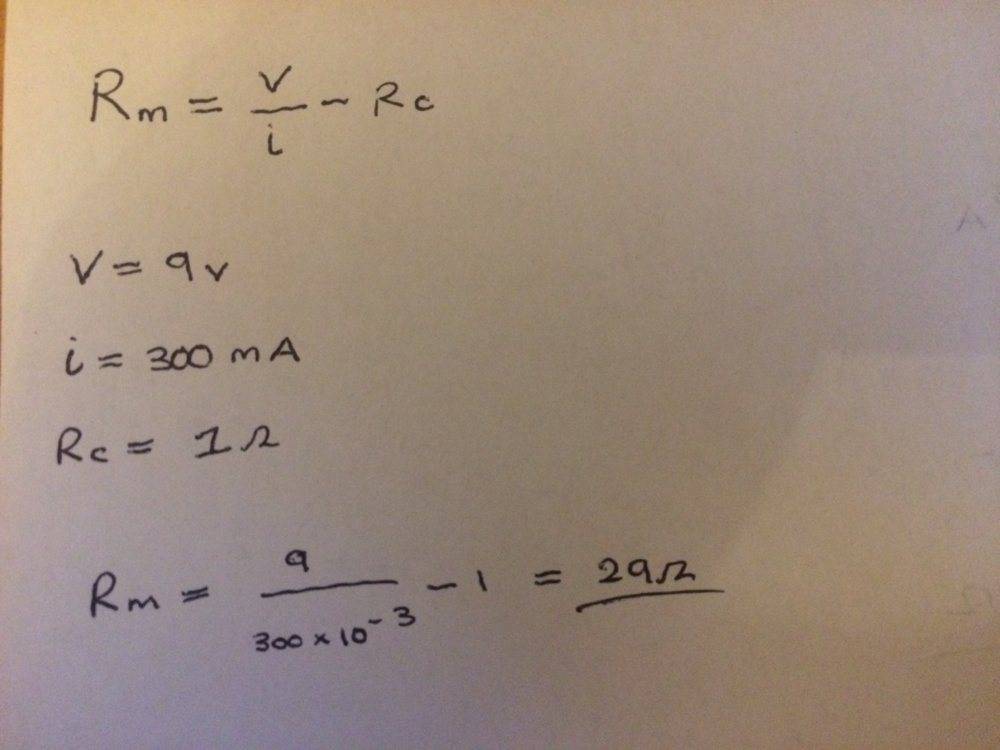

And this is what I have tried, I get an answer of 29 ohms
Would you agree?
PF isn't for stamp-approving homework. It's your exercise. You have to convince yourself you're right !
