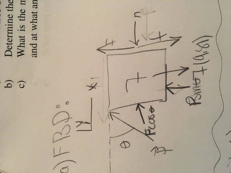

A block of mass 7 kg is pushed against a wall by force P. The coefficient of static friction between the block and the wall is 0.42. Determine an expression for the force P as a function of θ such that the block will not slide up the wall or fall down the wall.
a.) Draw a free-body diagram for this problem
b.) Determine the force value needed if θ = 13°
c.) What is the minimum force required such that the block will remain stationary, and at what angle should this minimum force be applied?
mg - f = Psinθ
n = Pcosθ
f = μscosθ
I honestly wasn't sure where to start out since we haven't done any vertical force problems in class (I'm in a summer mini term, so my teacher tends to just rush through everything). So far, this is what I have, but I know that I am probably completely off.
After doing my FBD, I decided that I could do part C to find the minimum force needed, but I just kept the angle at 13°, so I'm not sure I did that correctly, either.
mg - μscosθ = Psinθ
P(sinθ + μscosθ) = mg
P = mg / sinθ + μscosθ
P = 7(9.81) / sin13° + (.42)(cos13°)
P = 108.28 NThank you so much for helping! All of us in the class are just drowning right now.
Consequently you have found the answer to part b, at least on the assumption that the force direction is above the horizontal.
Along the way, there are a couple of typos. You missed a P in the first equation and you should use parentheses to make the order of operations right.
The very first part of the question is to find expressions in terms of a general theta for bounds on P such that the block will neither slide up nor slide down. How does that affect your general equation (before you plugged in 13 degrees)?
Part c requires you to find the least P over all possible angles.
