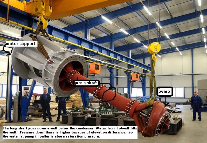

As a mechanical surely you're familiar with NPSH ?
The 'minimum' pressure you need there is determined by the saturated pressure-temperature curve of water. You don't want cavitation(micro-boiling) inside the pump that's circulating condensed steam from the condenser hotwell back to the boiler.
That's why power plant condensate pumps are so tall.
