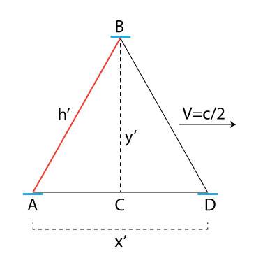

You know... part of the problem (the part about the motion of the emitter and wondering why the remote observer wouldn't expect the light go 90 degrees from the point of emission and miss the moving mirror) is that the translation of Einstein's writing confounds two terms.
The translations say that "the velocity of light is not influenced by motion of the emitter", but in German their word for velocity only means speed, not speed and direction like we use velocity as a vector in English.
If you read "velocity", and assume it is a vector sourced at the emission, the remote observer would expect the light to ignore the emitter's motion and travel 90 degrees from the emission point with respect to the rest frame of the remote observer, and miss the mirror...
  • #60

  • #62
harrylin said:
You imply that the horizontal position of the light scattering water molecules at different heights wrt the photographic plate S on the platform is x=0 at any height y.
I don't know why we are not in sync... I do not imply that. In post 17 I wrote:
"It is at the same horizontal y position at the moment of emission. But when it is detected some x distance away, the beam has moved in the y direction. So you will have the same y coordinate, but not the same t."
Cleay the two x's here are not the same, as I was talking about a x,y graph here just to visualize the detection of the scattered light.
In your setup, I realize now, you are trying to make that x=0.
But it doesn't matter, I fully accept that the setup will describe a diagonal. If the beam is up in the z direction, the distance between the plate and the beam is y and the chamber moves in the x direction, there must a change in x as time elapses due to the motion of the chamber and a change in y due to the motion of the beam. That is clear to me, and I thought I made it clear later on in many posts that I don't disagree with this. Just notice that by taking notes of the times of each x,y position, and the length of the line imprinted on the plate, you will directly calculate light to travel faster than c, but let's go on.
Take a light ray going straight up from bottom to top, as depicted on the left, but in a cloud chamber with glass walls, and to which we attach the label S'; necessarily scattered light from halfway up (at Y=0.5L) is also at the same horizontal position in S'.*
This is what I was talking about previously, if you consider the distance between the beam and the plate, the detection will mark the same x position but not the same y at each instant of time, since at each detection the beam has moved up a bit.
However, what if this cloud chamber S' is moving at very high speed to the right as observed by a stationary system S, as depicted in the sketch on the right?
The scattering water molecules at the bottom in S' will be detected at for example x=0 in system S.
However, while the light moves up in S', S' moves to the right. Necessarily the scattering water molecules at 0.5L in S' are not at x=0 in S, but are slightly more to the right. And the scattered light at the top is even more to the right.
IOW, by geometric necessity this is what must be measured in S.[/I]
Agreed.
However, according to your answer, the water molecules that scatter must be at rest relative to both plates! But that is not possible, for that corresponds to zero train speed.
what? It is not the scattering mecules that are at rest relative to the plates! It is the scattered light, the light that impacts the plate, that is "at rest". It has no x component. It moves straight from the point of emission towards the plate, regardless of the motion of the train. At each instant, light is scattered in all directions from the position of the beam. The beam can keep moving in any direction after that, but that will not influence the direction of the scattered light. The scattered light that reaches you directly has no x or y component, even assuming the beam does.
If we make the train high enough then the laser light can already be past the platform but still be leaving a trace on the photographic plate on the platform, following your analysis. :devil:
Of course it can. Remember, it is not the beam that is actually leaving the trace, it is light scattered from the beam. It is very possible that during the time between a certain point of emission and a point of detection the beam moved away from the platform. SR: from the beam's point of view, it leaves the platform at t. From the moving plate frame, it leaves at t + the time between emission of scattered light and detection on the plate.
Thus, once more: please explain in detail why you disagree with my above analysis.
Next we can discuss your light angle question, which I thought to have answered in post #8.
I don't disagree with it, i think that you are not paying close attention to the fact that it is just the cattered light that is detected, not the beam. You must collect your data with this light and than calculate the coordinates of the beam from that. From this point I must introduce SR to make my arguments. Just think about how would you normally apply the transforms in SR. You have to apply the transforms because your data is data from a moving frame, you don't know the primed times and positions of the points where light was scattered from. Once you do, you will get the left diagram. You can do this realistically using data brought by scattered light or you can do it fictitiously using the presumed path of the beam. Both get the same results, but the first is free from incorrect assumptions, the second allows you to believe that it is possible to directly observe light move faster than c, and that you can bring this back to normality with time dilation. But you can really never observe light to move faster than the speed of light.
At least we seem to agree that there must be a mechanism of data transmission between the plate / observer and the beam.
I realized it is crucial to state the the observer is NOT the scientist that processes the plate, it is the plate itself. You have already added scattered light to the setup, so the observer could see anything. The observer, placed in the same situation as the plate, will receive light scattered from a different point at each instant, and he can't use the observed times and positions to calculate the time it takes for the beam to go from y'=0 to y'=n (the primed space-time coordinates), he has to calculate the coordinates in the primed system first, using the observations brought by the scattered light, but not the "observations" brought by the beam.

The first thing i want to point out is that a photosensitive plate must actually be thought of as a set of spatially separated observers. The very fact that you need multiple detector cells, or that each detection occurs at a different place in the plate, is enough to demonstrate this.
The setup should have the observer fixed at some origin. Consider this:
All lengths and distances are primed because they are all locally measured numbers. If you like, imagine that before the experiment we have walked all the distances and measured them with a measuring rod. You can even imagine that we have marked each km with a big sign with the km distance painted on it, so even in the moving system S we know the primed spatial coordinates from direct observation.
Fix an obsever at A, his frame denoted by S.
V=c/2= the velocity of the light clock in the x direction, as shown on the onboard speedometer. Also, this velocity has been previously agreed upon, so there's no doubt that's the speed of the light clock.
BC=y'=1 lightsecond = the distance between mirrors (measured locally, remember) and this is a given.
AC=x't=0.5 lightseconds = distance traveled by the light clock in the x direction between reflection events TA and TB
TA=T'A= 0 = time of first recorded reflection, at both S and S' origins, which are both at A.
T'B=1s = the time of the second reflection event as calculated in the rest frame S' (I say calculated because it is half the time between two consecutive observed reflections in the bottom mirror, where we can assume the observer inside the light-clock would be fixed at)
TB=T'B + h' = the moment a reflection signal (i.e.: scatter event) from B is seen in S, which is the the time light takes to travel from the reflection event T'B to the observer at A.
This triangle represents the first two reflection events as seen in the moving frame S, where one mirror is seen at A when T'=T=0 and the other at B when T'=1, which are separated by y'=1 lightsecond.
The light clock is going at .5c, and this is given by an onboard speedometer, and has been decided from the begining, so the observer in S can assume it as given. But this velocity is only useful in this setup to determine AC. Since we are trying to get numbers from the beam going AB, that's where S should fix the x axis, just like in the train problem.
AB = h' = 1.12
TB = T'B + h = 2.12s
VAB = h'/TB = .53c
That's what the observer at A would conclude. You will say that we can't do it this way because we are using primed values for distances, and while S would really see them compressed, he can use primed numbers because they are already marked, so we can skip all the transforms.
It is also curious to notice that VAB is different from V'AB, and that this would seem to imply that the speed of light is not the same for all observers. This is the most important place to reestate that the beam is NOT observed in the same manner that we observe light. In this setup, the observations are of events (scatter events, radio signals, etc), and we receive the data from these events through EM waves, and it is those waves that always travel at c: detected light. Seeing light by secondary means can very easily change the relative speed of light, that's why I believe it is of great importance to remember always that we must consider light detection as a local event in all relativistic problems.
As a footnote, I want to point out that doing the inverse processo, using the unprimed values and transforming them into primed values, or correcting the speed of the beam to c, will result in the beam covering a straight line with the same length as y', and since we know from experiment that light travels at c, it must do so inside the lightclock as well, and that's how we would correctly diagram the behaviour of the beam, if we want to keep it's velocity as c. And that's why I have been saying that the only way we would correctly diagram the path of the beam is in the stationary frame. Light detection always occurs locally, and any .
My last remark is that it seems impossible to use the lorentz transformations consistently in this setup. First, it is hard to decide which V to use, since they are not the same for each observer, and secondly, the values don't add up either way. And if we plug in c for the speed of the beam, gamma vanishes, as we all know.
As it is, we have no clear position for the observer. As has been proposed in this discussion, we may include an observer that is large enough to cover the entire distances with, but that can only be consistent with SR if it is thought of as an array of observers. A single observer in SR must be thought of as a point at the origin of its own frame of reference, where observations are made from - or we should take the spatial separation between detections into account.
If you don't agree with the above, even if you're able to correct my analysis, I would like to see how you would deal with the setup such as I presented, with the same givens.
  • #67
I haven't been following this thread closely, but I'll take a crack at re-stating the problem and then giving a quick analysis.
You have basically defined four events, which I'll label A0, B1, C1, and D2:
A0: The light clock pulse is emitted.
B1: The light clock pulse bounces off the mirror.
C1: The spatial location of the light clock source/detector "when" the light clock pulse bounces off the mirror. We'll defer discussion of this event for a bit.
D2: The light clock pulse is received.
In the primed frame (i.e., the rest frame of the light clock), three of these events have coordinates (if I've understood you correctly), given as (t', x', y'):
A0': (0, 0, 0) -- the origin of the frame
B1': (1, 0, 1) -- the mirror is 1 light-second away from the origin in the y direction, so light takes 1 second to get to it. No distance is traveled in the x-direction.
D2': (2, 0, 0) -- light takes another second to get back to the spatial origin, where the source/detector sits.
Now we want to transform to the unprimed frame, in which the light clock is moving at v = 0.5 in the positive x direction. That means our transform from the primed to the unprimed frame uses a v of *minus* 0.5 in the x direction. The transformation formulas are thus:
t = 1.16 (t' + 0.5 x')
x = 1.16 (x' + 0.5 t')
y = y'
where 1.16 is the gamma factor associated with v = 0.5. This gives for the three event coordinates in the unprimed frame (t, x, y), where I have assumed that event A0 is the common origin of both frames:
A0: (0, 0, 0)
B1: (1.16, 0.58, 1) -- notice that the y-distance is still 1, because the relative motion is in the x-direction, so distances in the y direction are not affected. However, the mirror has traveled 0.58 light seconds in the x direction, in a time of 1.16 seconds according to this frame's clock (the light clock only registers 1 second, but this is the "time dilated" time from the viewpoint of the unprimed frame, i.e., it is the 1.16 seconds that elapse in the unprimed frame, times the time dilation factor).
D2: (2.32, 1.16, 0) -- similar remarks here, 2.32 seconds have elapsed in the unprimed frame, and the light clock has moved 1.16 light seconds in the x direction.
Now let's talk about event C1, the one I deferred discussion of. The way you have defined it, its coordinates in the unprimed frame should be:
C1: (1.16, 0.58, 0) -- the source/detector in the light clock has moved along with the rest of the light clock in the x direction, but it remains at y = 0.
But notice that this means the light clock has traveled 0.58 light seconds, according to the unprimed frame, between the events you are calling TA and TB (and I am calling A0 and B1). If we now transform back to the primed frame, we find that the primed coordinates of event C1 are:
C1': (1, 0, 0) -- the source/detector stays at the spatial origin at all times in the primed frame.
The above analysis looks correct to me, and I don't see any paradox anywhere; it just requires being careful about defining events and frames.
  • #68
Using your terms, the events would actually be:
A0: The light clock beam is emitted/reflected from bottom mirror.
B1a: The light clock pulse bounces off the top mirror - in the direction of the bottom mirror (towards D in the unprimed frame).
B1b: The mirror emits a signal towards A.
A2: The signal reaches the observer at A.
D2' doesn't enter the problem, since we are seeking just the time of the reflection on the top mirror and the behavior of the light beam from A to B from the point of view of the observer at A. We could include a third event in place of D2' which would be the time the observer receives the signal as seen from the light clock, but that is not what we are concerned with.
Now we want to transform to the unprimed frame, in which the light clock is moving at v = 0.5 in the positive x direction...
y = y'
...1.16 is the gamma factor associated with v = 0.5...
That can't be right, although I see your reasoning. Your are calculating gamma using the speed of the light clock, but we must place the x-axis in line with the beam (which would be h'), because we are seeking values for the beam itself. All your subsequent coordinates are then jeopardized.
Of course the conclusion that the detector stays at the origin is correct. But gamma is not correct here. Also, you are using 0.58 for the distance traveled from the point of view of the observer at A, but remember the only way the observer has to know this distance would be by knowing the velocity, but he knows only the speed of the light clock, not of the beam (he has to calculate it). You may say that he does know the speed of the beam, since it must be c, but that's an assumption I want you to hold for a second and imagine how that would actually be measured. That's why I placed km signs at every distance, so the observer can use the primed spatial coordinates to get the velocity and do the transforms.
The problem with your analysis and what I have been saying from the start is that the reflection event at T'=1s is not directly observed, it can only be calculated from some sort of signal emitted from the top mirror (B). And that has to be achieved by taking the primed space and time coordinates of that event and adding the time it takes for the signal to reach the observer.
Also, you are using the velocity of the light clock in the x direction, but that is only useful to determine the length of the opposite side of the triangle, so we find the hypotenuse (h') and calculate the time it takes the signal to reach A. I know this is confusing, but bare with me. Remember the train and embankment problem? We fix the x-axis in line with the tracks, because we are seeking numbers for the train. Here, we are seeking numbers for the beam, so our x-axis must be fixed in line with the path of the beam (h'), and plug in the speed of the beam. You can't plug in the speed of the light clock in the x direction, since that would only work if we were seeking numbers for the light clock's motion, which is not the case. Just as we plug the speed of the train to find gamma, we must use the speed of the beam here in the same way.
Another remark, it seem you are imagining the beam returning to the unprimed origin or something like that, but we don't need to worry about the path of the beam after this reflection. But if we were to take this into account, the beam moves back to the bottom mirror some further distance away (in the unprimed frame). The observer never sees the beam directly, the beam is always moving away from A, so it never reaches him. We need another light source reaching that observer bringing information from the beam if we want him to see anything. If we send a signal from the top reflection event (at T'=1s), and we are given the primed coordinates of that event, we just have to calculate how much time it takes for a light signal from B to reach the observer at A and calculate the speed of the beam from that. Remember that distances are given and times are observed in my setup, and we are given the speed of the light clock, but the speed of the beam can only be c over an assumption, otherwise it becomes clear that c only applies to light that reaches the observer, which is what I believe the postulate of the speed of light really means. We never see Einstein talking about the speed of light at a distance, since that light is plainly undetectable. It is a constant relative to the source and the observer, but that says nothing about the speed of light relative to a non-observer.
At the very least, even if you don't agree with the bulk of my analysis, I think it should be clear that the present light clock diagrams are illogical, or incomplete, since the position of the observer is never defined, nor the process by which the beam's path is determined in the unprimed frame.

So please, given primed distances and times, taking the observer to be at A, a beam moving from A to B, and a signal is sent from B to A at the time of reflection (T'=1s), how would you solve? You know the distance between A and B is h' (1.12). What is the observed time for event B in the unprimed frame?

Hi, Harry. That may have been your point, but did you check if it works? If instead of a beam we had a dark (undetectable) bullet going from A to B, with this set of givens:
h'=1.12
T'A=0s
T'B=2s
How would you solve? Is the speed of the bullet as seen from inside the bullet-clock the same as the speed of the bullet as calculated by the observer at A? And how does replacing the bullet back with the beam change our operations?
Yes, I checked this several times in the past, enough to make me realize that I was merely verifying that the Lorentz transformation really work. Did your calculation test your claim that it (in fact the Lorentz transformation set) doesn't work?
h'=1.12
T'A=0s
T'B=2s
How would you solve? [..]
You still haven't answered the questions I asked in post #78. Is the motion of the light clock perpendicular to the direction the light pulse goes, or parallel to it? Are there two light pulses, or only one? Nobody can "solve" anything until we know what the scenario is.
I thought this was already clear from the diagram but I'm glad to clarify. The clock moves perpendicular to the direction of the light pulse (the line drawn from one mirror to another in the rest frame). There's a light pulse going from A to B, which we have been calling the beam and is the pulse that makes the clock tick by moving between the mirrors, and there's another pulse from point B to the origin to communicate the time of the reflection event to the observer, since he can't see the beam in this setup. (harrylin has been proposing scattering so that the observer can see the beam also, so you can replace the signal with the scattered light coming from B, but it works just the same).
And since we are looking for numbers for the beam we really need the spatial rotation so that the observer's x-axis is in line with AB.

I agree. We are given t'B=1s and we are looking for T. Place AB=h'=1.12 as your arbitrary direction, find T with a given t'B=1s. That's the time the observer will see the object reach B, and the "object" is the beam. What is the apparent velocity?
Ok, good.
Ok, this was the part I hadn't understood. Now it's clear. See below for revised analysis.
It doesn't matter whether it's the x or the y axis; I had picked the x-axis for the direction of motion of the light clock as a whole since that's a common convention in SR problems. To humor you I'll re-do my analysis with the light pulses moving in the x-direction and the light clock as a whole moving in the y direction relative to the observer.
We have two frames, the "observer" frame (the frame in which the observer is at rest), which will be the unprimed frame, and the "clock" frame (the frame in which the clock is at rest), which will be the primed frame. The relative velocity between the two frames is v = 0.5; the light clock is moving in the positive y-direction in the observer frame (and therefore the observer is moving in the negative y-direction in the clock frame). The gamma factor associated with this v is 1.16 (approximately). So the transformation equations are:
Unprimed to Primed Frame
t' = 1.16 ( t - 0.5 y )
x' = x
y' = 1.16 ( y - 0.5 t )
Primed to Unrimed Frame
t = 1.16 ( t' + 0.5 y' )
x = x'
y = 1.16 ( y' + 0.5 t' )
We have six events of interest (two pairs of events occur at the same point in spacetime and so have identical coordinates, in either frame):
D0 - The light clock source emits a light pulse towards the mirror.
A0 - The observer is co-located with the light clock source at the instant that the pulse is emitted. Thus, events A0 and D0 happen at identical points in spacetime. This point is taken to be the common origin of both frames (moving the origin elsewhere would just add a bunch of constant offsets in all the formulas, making the math more complicated without changing any of the results).
B1a - The light pulse reflects off the mirror.
B1b - A light signal is emitted by the mirror back towards the observer, carrying the information that the light pulse has struck the mirror. Events B1a and B1b happen at identical points in spacetime.
A2 - The observer receives the light signal emitted from event B1b.
D2 - The light clock detector (which is co-located with the source) receives the light pulse that was reflected off the mirror.
We know that the spatial distance between the light clock source/detector and the mirror, in the clock frame, is 1. This, combined with the information that events A0/D0 are at the origin, fixes the following coordinates (primes on the event labels denote coordinates in the primed frame):
A0 = A0' = D0 = D0' = (0, 0, 0)
B1a' = B1b' = (1, 1, 0)
D2' = (2, 0, 0)
Simple application of the transformation equations above gives the unprimed coordinates of B1a/B1b and D2:
B1a = B1b = (1.16, 1, 0.58)
D2 = (2.32, 0, 1.16)
All of this is the same as I posted previously, just with the x and y coordinates switched, since you prefer to have the x-axis oriented in the direction the light pulse travels.
It only remains to calculate the coordinates of event A2. It is easiest to do this in the unprimed frame, since the observer is at rest at the spatial origin in this frame. Therefore, a light pulse emitted towards the observer from event B1b has to travel from spatial point (1, 0.58) to spatial point (0, 0). A light pulse's worldline must have a zero spacetime interval, so the elapsed time in the unprimed frame must satisfy the equation:
\Delta t^2 - \Delta x^2 - \Delta y^2 = 0
or
\Delta t = \sqrt{ \Delta x^2 + \Delta y^2 } = \sqrt{ 1 + (0.58)^2 } = 1.16
Which of course is just the gamma factor. We could have seen this directly by realizing that the time elapsed in the unprimed frame from event A0 to event B1a must be the same as the time elapsed in the unprimed frame from event B1b to event A2; but I wanted to calculate it explicitly to show how everything fits together. [Edit: In other words, I wanted to show that we don't have to *assume* that the light signal travels at c, which is what "zero spacetime interval" means. We can *prove* that it must, by comparing the result we get from the direct method I just gave, with the result we get from the interval calculation I just gave, and seeing that they are the same.]
So we have the unprimed coordinates for event A2:
A2 = (2.32, 0, 0)
Again, a simple calculation using the above transformation formula gives:
A2' = (2.68, 0, -1.34)
What is this telling us? Well, the observer is moving in the negative y-direction in the primed (clock) frame, so the y-coordinate of event A2 is negative in this frame. The time in this frame is *larger* than that in the unprimed frame because it takes extra time for the light signal to catch up to the observer since the observer is moving away from it. We also expect this from the relativity of simultaneity: events A2 and D2 are simultaneous in the unprimed frame (the reason why should be obvious from the discussion I gave above), so they won't be simultaneous in the primed frame; the event that is in the opposite direction from the relative motion (A2 in this case) will occur later in the primed frame.
Once again, this is all straightforward analysis and I don't see a paradox anywhere; it just requires being careful about defining events and frames. I'll put any responses I have to other comments you've made (now that I know we are both talking about the same scenario) in a separate post.
Edit: I suppose I should add that it's easy to confirm that *all* of the light pulses travel at c, in both frames, from the coordinates that I gave above.
This is not correct; what you are trying to calculate here is the unprimed coordinates of an event that I didn't list in my analysis:
D1 - The event at which the light clock source/detector is located at the instant the light pulse reflects off the mirror, in the unprimed frame.
The unprimed coordinates of this event are obvious from my analysis:
D1 = (1.16, 0, 0.58)
i.e., the same t and y coordinates as B1a/B1b, just x = 0 instead of x = 1. This means, of course, that the distance AC is 0.58, *not* 0.5, in the unprimed frame. And, of course, the velocity of the light clock source/detector, which is just the y-coordinate of D1 divided by the t-coordinate, is 0.5, as it should be.
The transformation equations give for the primed coordinates of event D1:
D1' = (1, 0, 0)
which is obviously what we expect given the primed coordinates of B1a/B1b.
altergnostic said:
AB = h' = 1.12
VAB = h'/TB = .53c
These are incorrect as well, as you can see from my analysis:
- The distance AB, in the unprimed frame, is equal to the gamma factor, 1.16; I don't know where you got 1.12 from.
- The time TB is the t-coordinate of event A2 in the unprimed frame, which is 2.32, i.e., twice the gamma factor; it is *not* obtained by adding T'B and h, which makes no sense since you are adding quantities from different frames.
- The relative velocity VAB, which as I understand it is supposed to be the velocity of the light clock as calculated by the observer, is, as I showed above, 0.5 no matter how you calculate it, as long as it's a valid calculation. Even with a correct value for h' and T'B, dividing them to get a relative velocity is not valid, and I don't understand why you think it makes any sense.
