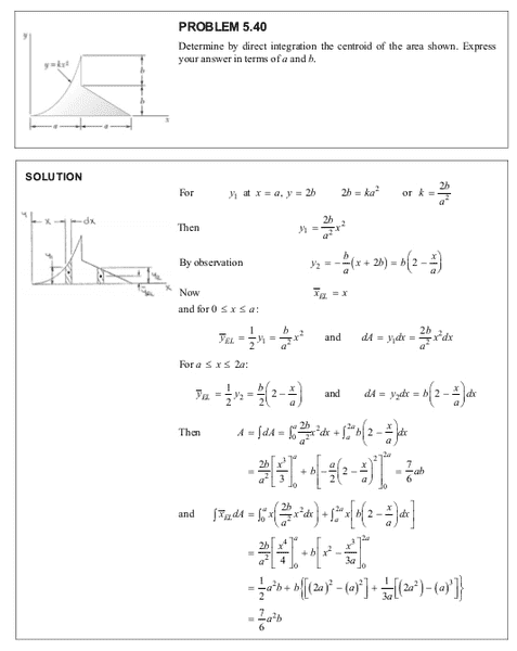

In the context of centroids and moments, what do ##\bar{x}_{\textrm{el}}## and ##\bar{y}_{\textrm{el}}## represent?
For example:
$$\bar{x}L = \int \bar{x}_{\textrm{el}}dL$$
The integral itself looks like a first moment, where the integrand is a function of position. I have no idea where this came from, so I can't go into any more detail.

Here are some resources that utilize this notation:
  1. (page 1) http://www.sut.ac.th/engineering/Civil/CourseOnline/430201/pdf/05_review.pdf
  2. Vector Mechanics for Engineers:Statics and Dynamics by Ferdinand P. Beer & E. Russell Johnston J.
Below is an example problem Beer's
For example:
xEL and yEL represent the location of the centroid of a tiny element of length dL or a tiny element of area dA used to calculate the first moments of length or area.
Study pp. 1 and 2 of the link carefully. :wink:
