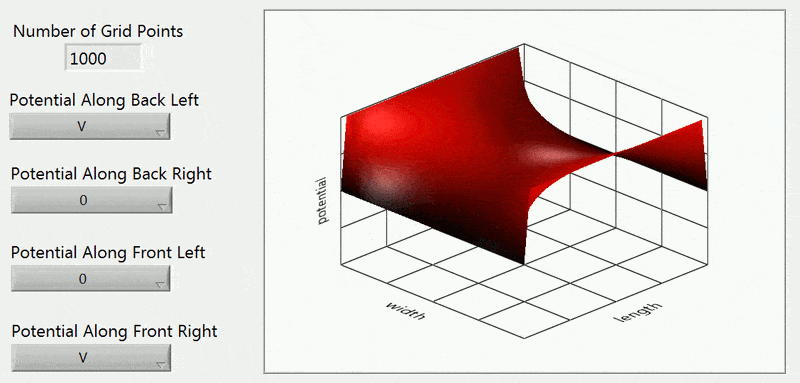

If [itex]\nabla \times \textbf{B}=0[/itex], then from the vector identity: [itex]\nabla \times \nabla ψ=0[/itex], we can write [itex]\textbf{B} = - \nabla ψ[/itex].
If we also have [itex]\nabla \cdot \textbf{B}=0[/itex], then substituting in, we find:
[itex]\nabla^2 ψ=0[/itex]
This is the Laplace equation, and it has many possible solutions depending on the boundary conditions.
Perhaps thinking in terms of magnetic field line diagrams is more helpful. A diverging field means the field lines emanate out in all directions from a source point. A curling field means each field line forms a closed loop by connecting back to itself. So a non-diverging, non-curling field just means that the field lines don't emanate from a point or connect back to themselves. There are many ways to draw non-zero field lines that don't curl or diverge.
In general, every vector field has potentially three natures that are, in a sense, "orthogonal": (1) it's curling nature, (2) it's diverging nature, and (3) it's relaxation nature. I call it relaxation, because the solutions to the Laplace equation look like sheets of rubber stretched across a boundary that have relaxed to their most natural shape.

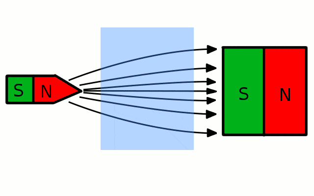

maCrobo said:
Chrisbaird you are absolutely right, but in that "relaxation" state vectors that makes the field are kind of disordered in the space so not to have any sort of behavior like curling or diverging, then we can say the overall result is approximately zero in our set (portion of space).
Practically a sort of relaxation arrangement can be found in a system full of atoms spread in such a way that their magnetic moments adds to zero (or almost zero :P ). Anyway from the macroscopic point of view the result can be seen as zero.
No. "Relaxed" vector fields (non-diverging, non-curling) are not disordered. Quite the opposite - they are the most ordered fields of all, and can definitely be non-zero. Consider the two magnets in the diagram below. In the volume of interest alone, shown as the blue shaded box, the magnetic field lines are neither diverging nor curling, and yet they are very ordered and very non-zero.
