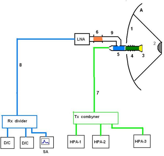

Dear colleagues.
please help in solving the actual problem:
Our company operates in the field of space communications .
For reception and transmission of signals via satellite is used parabolic antenna with a diameter of 12 m
Frequency of received signal is 4000 MHz.
The receiver is a Low noise amplifier with an effective temperature of noise 40 K.
At times, the noise level in the receiving circuit increases sharply in 8 times, then after some time, it returned to normal.
The same antenna near shows no increase in noise.
What might be the cause of the noise ?
How can we remove it ?

So, this is the antena and feed system:
1- 12 m parabolic antena
2- counterreflector
3- horn
4 -polarizer, Tx- LHCP, Rx- RHCP
5 -Tx/Rx coupler
6 -Tx/Rx filter or izolator
7 -Tx waveguide
8 - Rx coaxial feed
9 - Rx waveguide
LNA - "LNR" company, 3600-4500 MHz, 60 dB gain, 38 K
Tx C-band: 5900 - 6400 MHz
How
How exactly are you measuring the noise. (When you say "8 times more noise" do you mean 9dB higher noise floor at LNA output, 9dB worse SNR after DSP etc ...)
Have you tried disconnecting the TX path, terminating the TX input to the coupler?
Have you tried installing a waveguide termination on the antenna side of the LNA and verifying the noise figure of the LNA without antenna?
How long is the RX coaxial feed (8). If it is lengthy you may want to drag your spectrum analyzer out to the LNA.
You say that you have another system that does not exhibit this problem, how far away is it (miles, feet...)?

Trying to reply Your questions:
"8 times more noise" = 9 dB higher noise floor at LNA output, and 9 dB worse SNR after D/C,
9 dB worse Eb/No for modem operation.
We have tried to put a piece of beyond waveguide at TX input to the coupler
( Beyond waveguide has very big loss for Rx signals).
We have tried to replace the LNA
RX coaxial feed (8) is 15 m.
Another system that does not exhibit this problem, is 100 m far .

I still don't understand what is common between the problem antenna and the one that 100m away. Is that a complete system 100m away? or is there a feed from each antenna? Is there an LNA at each antenna? etc
EDIT: Sorry --- somehow I missed the picture

OK that's some answers :smile:
how regular/irregular is this change in signal ? several times an hour ? several times a day ?
what happens if you disconnect the coax at the RX divider ( exactly what is that? is the RX signal being split to other places other than the SA you have shown ?) and replace the coax feed with a dummy load ?
try that and see if the problem remains. That will localise it to the receiving system or to the coax/LNA and rest of the feed system
if the problem still remains then look at your RX system/SA for a fault
if the problem disappears, disconnect the LNA and try the dummy load on the end of the coax at the LNA end
You need to be methodical with your fault finding ... work your way through the system section by section, eliminating each stage as the source of the problem
Once you have proven no problems with your system, the only real choice left is intereference from some other RF source nearby

Well, dear colleagues, thank you for your help.
Actually we already eliminated this problem. And it was even 10 years ago. For the first time when the failure appeared, we do not know what to do. Thank God quickly found treatment. Conditionally it looked like this: our operating channels worked at frequency of 6200/3880 MHz. When there is an obstacle, we spent 10 minutes to fine-tune antenna, check the power of the HPA. Then someone offered to send power transmission on the next frequency 6150/3820 MHz and a hindrance was gone ! We did not change frequencies of operating channels, only used "empty" channel on the next frequency. Further we had time, slowly deal with the problem. It took almost a month. So the source of the noise, we found it in our opinion were noises by the LNA. The LNA has an input impedance of 50 Ohm and according to the Boltzmann law emits the white noise with a temperature of 300 K in the direction of feed and horn. This noise somewhere in the feed is reflected and returned to the input of the LNA.
After the antenna has been modernized by replacing feed, horn and others, the accident never reappeared.
Left with two questions:
Why the noise of LNA is reflected in the feed ?
Why adjacent channel power elliminates noise ?
