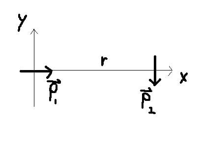

Two electric dipoles, oriented as shown in the figure, are separated by a distance r.
What is the force on p1 due to p2
F = (p dot ∇)E
I'm confused on the p dot ∇ part.
How is the divergence of p not just zero?
It seems p1 would just be some constant in the x hat direction.
