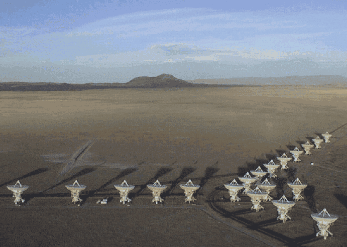

Can I presume that the set of telescopes that are to be used to view a single object are at least in a circular pattern?
Why would you wish to presume this? Do you imagine that radio interferometers need to have their individual dishes to be placed precisely on the circumferences of circles or squares? Quick answer is that they don't: it's sufficient that their positions are known to a high degree of accuracy.
Here's the VLA in New Mexico:

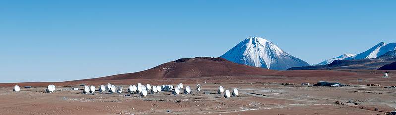

and here's the ALMA array in Chile:

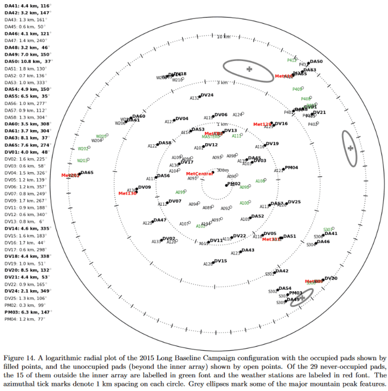

and here a plan of some of the antenna pads at ALMA:
245624
which displays antenna pads on a logarithmic radial scale: nonetheless, you'd be sorely challenged to find a group of more than one or two which sit on an arbitrary circle.
