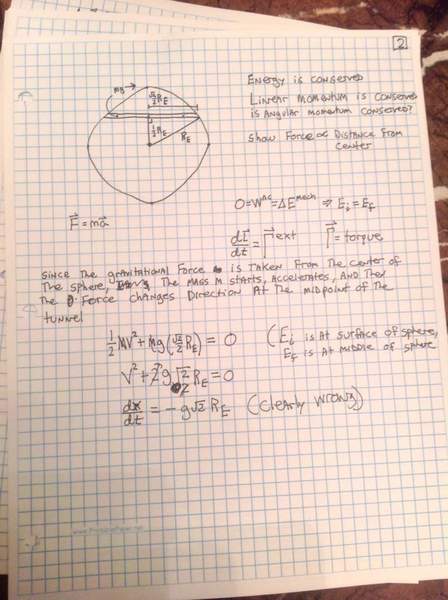

A tunnel is drilled straight through the Earth from Detroit to Zxxiuw. At the middle of the tunnel it is at 1/2 Earth radius from the center. Assuming that a mass m placed in the tunnel will slide without friction, show that it experiences a force that is directly proportional to its distance from the center of the tunnel. Give an expression for this force in terms of the distance and the weight mg at the surface. Assume the Earth is not rotating, a bad approximation, but hey, you're not going to drill this tunnel anyhow.
I am thinking I need to use energy and then take the derivative to get the force, but I am having trouble finding out the right assumptions to make such that I can do that.
That there is the problem, I am on an iPad so in the attachment is a picture of the problem as well as what I've been able to work out.
Thank you in advance

The problem is to prove that the force is directly proportional to the distance between the mass and the centre of the tunnel. What forces act on the mass when it is at a certain position in the tunnel? Recall that the force of gravity at distance r from the Earth centre is [STRIKE]equal[/STRIKE] proportional to the mass of the sphere with radius r, assuming homogeneous mass distribution of Earth.

What you really need to know is some facts about Newton's law of Gravitation, and you need to assume the mass density of the Earth is constant everywhere.

Okay so I just realized there is not zero kinetic energy at the center of the sphere, so that changes my energy equation, mgRe=1/2mv^2+mgr=1/2mgRe plus another kinetic energy term but those are both unknown velocities, the only thing I can think to do is cancel the kinetic energy and integrate, even though that doesn't give the force. I'm lost here.

Then pay attention to ehild's more detailed clue. The acceleration of a mass at radius r is only coming from the mass inside of r. There is a calcuation to do.
The gravitational acceleration is not g inside the Earth, the force of gravity is not mg, and the gravitational potential energy is not mgr.
Derive the expression for the force of gravity at distance r from the Earth centre.

I have that expression and tried to integrate using the second law, but I got a pretty ridiculous solution to the differential equation

I just used Newton's second law, GMem/R^2 = mdv/dt, then separated time to the LHS and integrated, but that this point I'm just kind of playing around with it, I actually got so mad about it I went onto another problem.

Or excuse me a=dv/dt. I left the problem for a moment, but I feel like I should be using energy. I don't see a way to express the force unless I use spherical coordinates but that makes me a very hard problem and I am not if I should be in 3d.
Newton says that if you are inside of a spherically symmetric mass distribution at radius r, like an ideal earth, then you can calulate the force due to gravity by treating all of the mass below r as concentrated at the single point r=0 and you can ignore the mass above r. So the force is F=GM(r)m/r^2, where M(r) is the mass of the material below radius r. Assume the Earth has a constant density ρ. What's M(r)? There are no differential equations involving v and a to solve here.
If you mean R the radius of Earth than GMem/R^2 is the force of gravity on the surface of Earth, and dv/dt is the acceleration on the surface of Earth, that is g≈9.8 m/s2. The problem does not ask velocity, why do you want to integrate it?
You need the force of gravity inside the Earth. Proceed according to Dick's hint.
ehild
