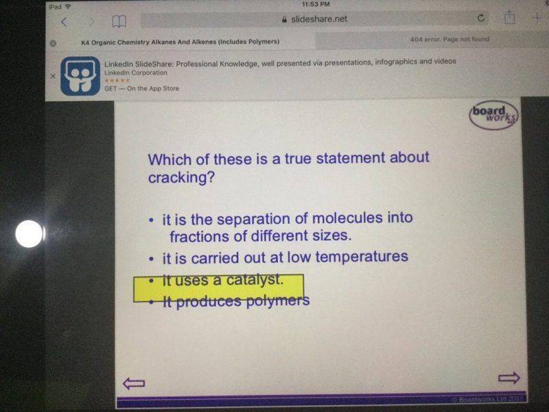

Here is the question and the teacher says D is the correct answer
But I found a ppt online with the same question with a different answer
Please help and give a reason
The bottom pic is the dispute
The first pic is the ppt
Thank you

http://www.goffs.herts.sch.uk/documents/science/as_chem/unit2_f322/alkanes/cracking.ppt
This is where the original presentation was found
If the presentation is downloaded and opened in PowerPoint then the answer is C
But if it's opened in a Mobile device like iPhone, then the answer sort of varies over D and C
I guess the teacher is fixated on that and says its D
But we cannot say D cause it produces monomers which can be used in polymer production but the product is NOT a polymer right?

It has being decided that as the power point presentation showed, choice C is the best one in this case
