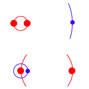

Note that there is more than one type of binary planetary system. For example:
- a planet might have a wide orbit about the barycentre of a tight binary
- a planet might orbit only star A while star B is a distant companion
Likes diogenesNY, delie, Astronuc and 1 other person
