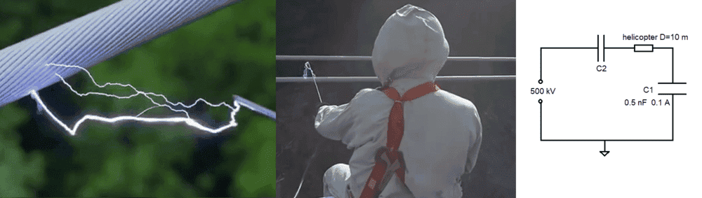

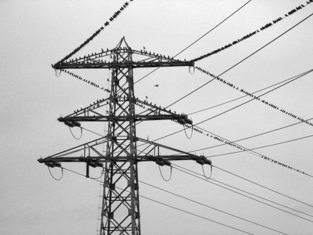

Birds seem to avoid transmission lines above 50 kV. The ground wires, which do not carry current, except in the event of a lightning strike, need to be distinguished from the power transmission lines. The ground wires are the ones that are not separated from the pylon by a stack of insulating discs. On this photo of a 150 kV line, the birds are sitting exclusively on the ground wires, and evidently avoid the power lines.
242581
A bird landing on a power line resembles a helicopter with a lineman approaching the power line. When the helicopter approaches the line, a continuous spark develops. (youtube) The helicopter has a capacitance to Earth and to the line. The capacitance to Earth for a somewhat spherical object with a diameter of 10 m is C1 = 2πεD = 0.5 nF. If the voltage is 500 kV and 50 Hz, the estimated AC current is 0.1 A. That is not impossible, when looking at the spark on the photo. The bird is 50 times smaller, its capacitance is 10 pF, and the current from a 150 kV power line is 0.5 mA. That is small, but maybe the birds are able to feel it.

John3509 said:
, but the issue here is why it doesn't harm the birds,
It will if the voltage on the transmission line is high enough...
As was shown to you earlier post #7, birds keep away from EHT transmission lines as they can easily sense the
very high electric field around the lines.
If you or I or a bird could stand on an EHT cable (unprotected) with our feet spread apart,
there would be enough of a potential difference between our feet that we ( the bird) would be shocked
As our or the birds body forms a parallel resistance with the section if power line between the 2 feet

spareine said:
Yes, in my diagram the helicopter can be replaced by the bird just before touching the wire. The part of the bird closest to the power line, its feet, is one plate of capacitor C2, and the part that is furthest from the power line, say its head, is one plate of capacitor C2. When AC current is flowing through the bird's body, the excess charge is jumping between its head and feet. A little later, when the spark develops or when the bird is touching the wire, C2 is shorted out, and the excess charge is jumping between the bird's head and the "earth". The excess charge equals Q = CV = 150 kV · 10 pF = 1.5 μC = 10^13 electrons.
Yes, the size of the bird matters, smaller birds experience smaller currents, whereas larger birds and helicopters experience larger currents.
You modeled the feet and the head as separate capacitor plates, I was not expecting that, how I imagined it is since current would enter the bird at one point, pass trouigh its body, and exit somewhere when it is in a circuit, since it only has an entry when it sits on the power line the electrons would just be pumped and compressed in the body, like the whole bird would have an excess charge, not just the feet.
The helicopter and receives a larger current because it can hold more excess electrons before the current to it stops?
I also would not model the bird as two plates. To do that you would need to say that the rest of the bird is a dielectric, but birds conduct reasonably well (chicken conductivity is used reliably in slaughterhouses)
Two plates separated by a dielectric is a traditional capacitor, which has “mutual capacitance”. What we want here is “self capacitance” which treats the bird as a single (strangely shaped) plate.
Basically, you can think of it as a standard capacitor where the second plate is at infinity. This is what I described in my previous post.
Maybe this schematic is clearer. Capacitor C2 is the air gap between feet and power line before landing. After touchdown, it is just an ohmic contact. The only importance of C2 is that its air gap is the location of the electric arc. My thought was the bird may be more sensitive to a current in the form of an electric arc during landing, than to the same current spread out over a larger contact area after landing. There is no dielectric in the model, only air and conductors.

Just to elaborate... (waffle some more?:cool:) it is interesting to see the pic in another post of a guy in a hoodie holding a sparking rod... but there is no explanatory caption... :confused:
So, I'll try to fill in a little. A hoodie...? Er, not really. A Faraday Suit! Eh? Like a Faraday Cage, except personal!
What is going on? Well, the guy is approaching a live high tension line, probably 'cos he has to work on it. Why hasn't it been shut down? Probably 'cos that would mean shutting down an entire area of the countryside. And anyway, with the right kit, he doesn't have to!
So, as he approaches the line, he reaches out with a conducting rod that is connected to his suit. This will bring -the suit's- voltage (and that of the guy inside!) up to that of the power line, (without any voltage gradients across any part of his body) and as we can see, (from the spark!) -massive- current is being passed! Not just because of the guy in the suit is acting as a capacitor, but because the power is passing into the suit, and then discharged into the environment -from the suit-, and -not- through/from the guy himself.
As for 'feeling it'... (ie, feeling the voltage gradient I mentioned above) I spoke to a friend who did this kind of work. And being an adventurous kind of guy, he said yes, he'd wondered about this too... and he decided to conduct a lill' experiment. Yes? He wondered what would happen if he tried -removing- his suit while connected up to a -very- high voltage line! 😁
And what happened? Well, he said that as he began to open up his 'hoodie', (no rush!) he began to 'feel the electricity in the air'! And after he got the hood of the suit less than halfway off his head, he could stand it no more, and promptly put it back on!
Shocking stuff!

Don't see birds on extra high voltage lines because of high density leakage and capacitive currents. EHV leakage currents would be unbearable for the birds.
I once watched a beautiful Golden Eagle land with a wing crossed over a transmission line and its other wing on the spreader. The eagle immediately combusted and caused enough damage that PG&E had to look at the tower from one of its helicopters.
It was always my understanding that birds do not exhibit enough of a path through their two legs for a current to leak off the less resisted transmission line.
I still carry the scar from leaning against a high voltage distribution line while climbing a tree when I was 10 years old. Simply being in the tree gave enough of a circuit through my arm to create a nasty burn.
